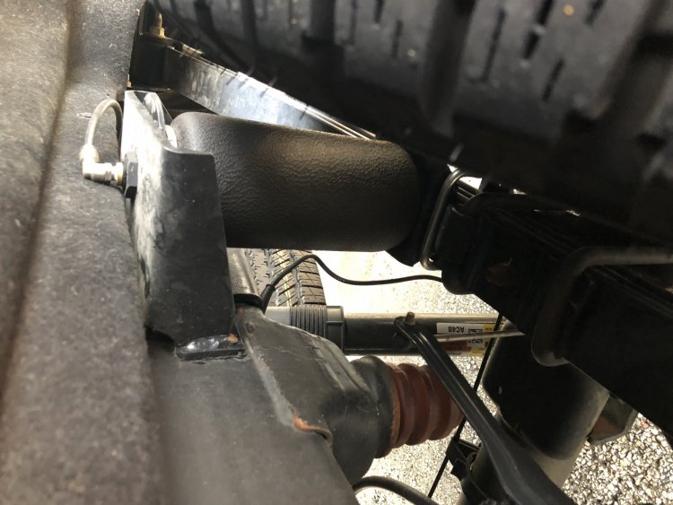

I am running air bags in my 18 Denali. I found a set from Air Lift ( Ride Control bags) (2,000lb bags) that mounts to the outside of the frame and the top of the leaf spring which does not effect your magnetic ride arm. I pull a 7000 + lb boat all over the place.. Big difference with helping with the sagging in the rear without affecting the ride quality. I also have a 2” leveling kit in the front.....   My old bags from them mounted to the axle and frame which would not work with the Denali, obviously cause of the shocks...
would you mind posing what part number you used?
thanks
Here’s a better pic so you can see how they mount.
I have saw those but never really paid them much attention. They don't stiffen your ride when unloaded? Running 7 psi in the rear unloaded like regular bags?
Sent via Morse code
