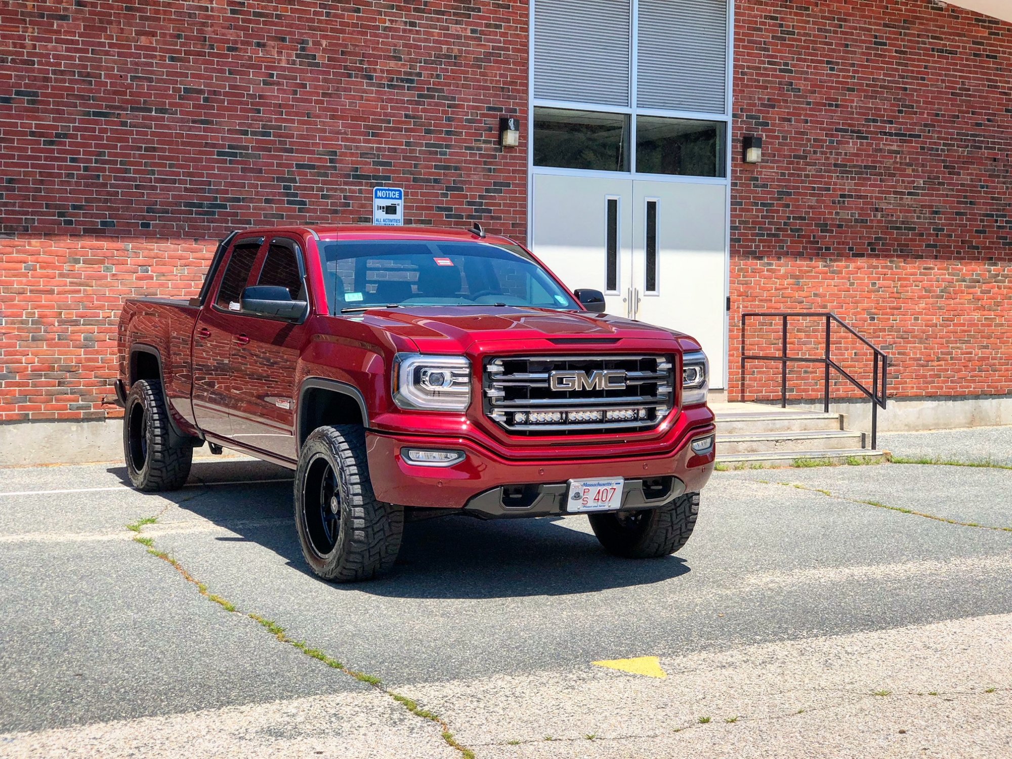

2017 Sierra 1500 with a 2.5" Motofab upper mount spacer and Readylift tubular UCA running 20x10 -19 Hostile Sprockets and 33x12.5r20 Toyo RT. Minor rubbing on the back of the fender reversing full lock. First picture is the front end height comparison between my 17 and my buddies stock 18.
IMG_7356.thumb.JPG.824d5f0fb864dc2df40ec0261ee0092c.JPGIMG_7326.thumb.JPG.d6216ce905268d0a3a89d7187af6d502.JPG

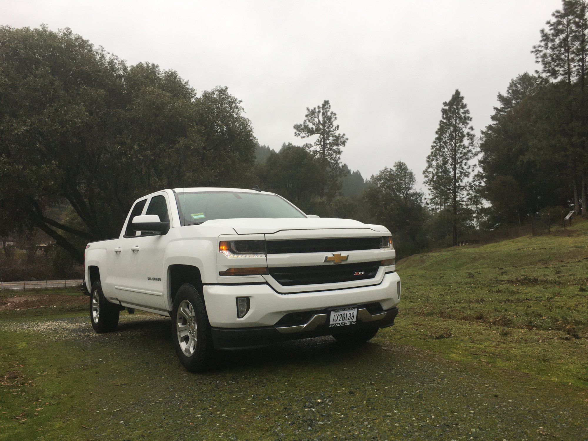

Hate to resurrect an old thread, but it caught my eye. I have a 2019 LD(2018) Silverado Z71. It came with the 18” wheels. I’d planned on buying the Eibach Pro kit that lifts your front 2-2.5”. Planned on running 275/70-18 on stock wheel. Will it hit my UCA?
Another wheel I’m considering is the Enkei RPT1 in 18x9 with 0mm offset and 5.078” backspacing.
Pic of white truck is the one in question.

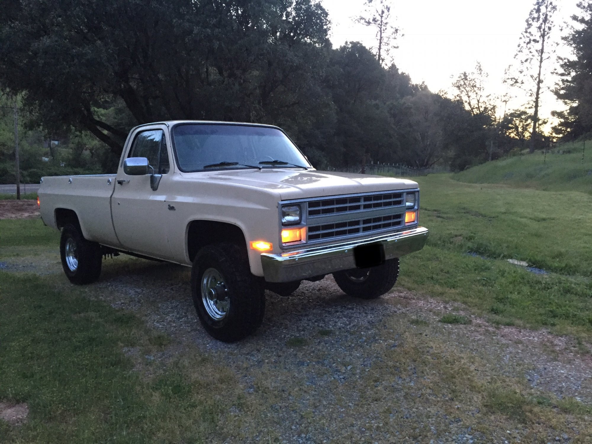

Pic of tan truck is my CUCV square just for fun.
