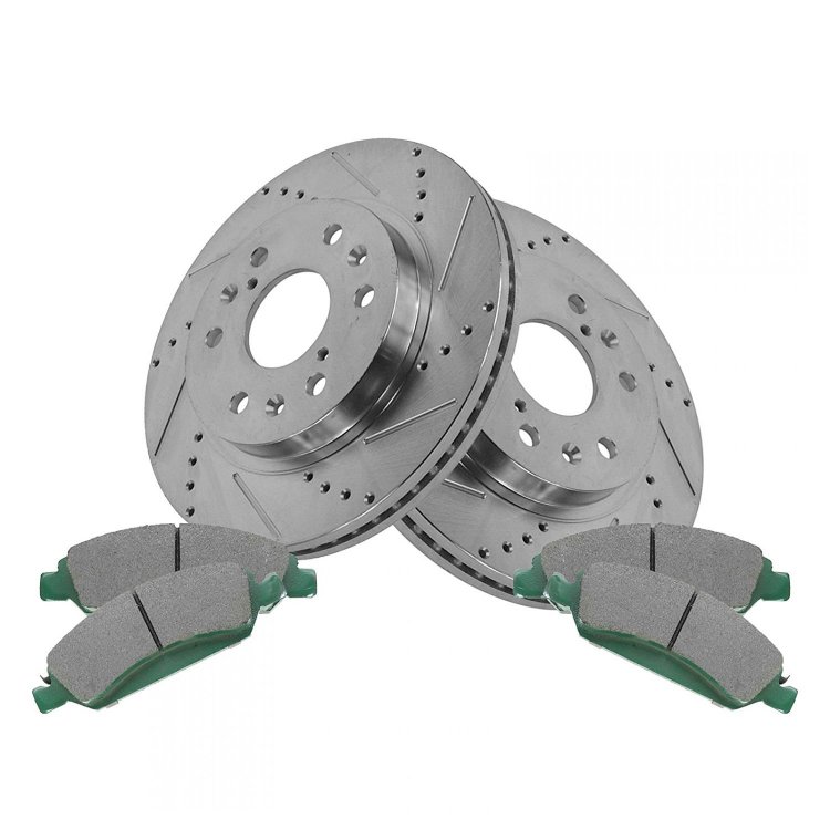

2 hours ago, gearheadesw said:
Come on man, those are 1500 series brakes, big difference.
   I have no doubt that they are the incorrect parts for your exact vehicle. You would always want to verify fitment prior to purchasing the parts. That link is more of an example, rather than the exact item you should purchase. The brake pads in that link are ceramic. You may prefer semi-metallic, metallic, carbon fiber, etc. Try searching around Amazon, and sort by lowest price first.
