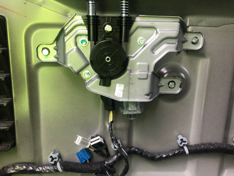

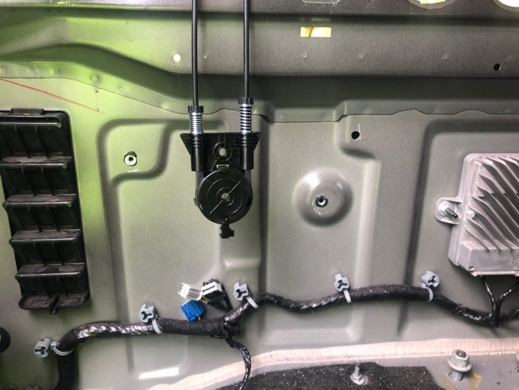

Ok changed out from solid and now have a power slider. @pgamboa really helped me out. This guy knows the wiring of these trucks like the back of his hand.
So if someone wanted it shipped and paid for it, the solid is available to ship now as well. Packed in box ready to go. 188901e297641d7af1bee751ef18de5f.jpg
This is after the swap. She is a sexy one. If anyone wants to n ow where motor is this is where you place it. ac8f768714a7403124e97f748c3572c2.jpg
  • Thanks 1

Nice!  I installed the GM power slider in my uplevel 2018 SLT.  It was pretty much plug n play.  Did you have to drill holes through the cab to mount the power slider motor?  I did not have the threaded studs in place.
No I used elevator studs and jb weld. After it dried it worked great
