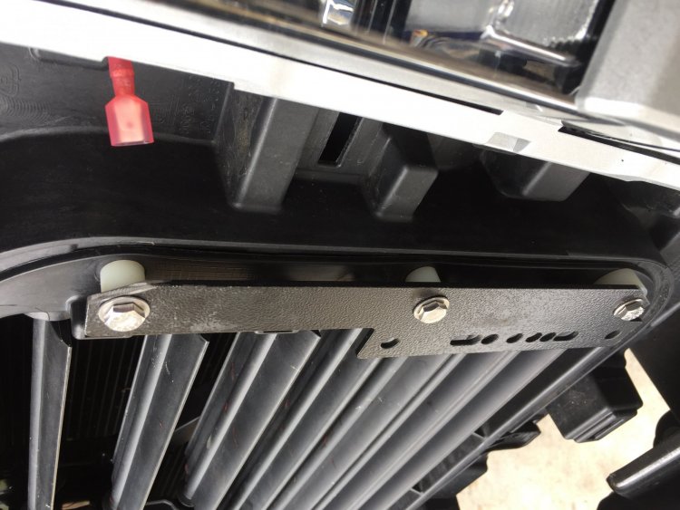

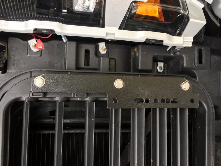

Had to use 1/2 stand offs to clear the active grille. Depending on where you are mounting it,  I had to trim two of the shutters and an adjacent plastic piece as shown in the picture to clear the nuts for the other brackets.  I am mounting it in the row above the Z71. Will post more photos as I progress

Yes. That’s what i’m working on now. Got the brackets mounted with minor trimming to the fins on the active shutters.
Update:  After I installed the brackets the grille will not go back on. So I had to trim the brackets for it to fit. It’s a tight fit but it worked. See pic.6A998949-D52B-4EAE-A508-73B12704A7B4.thumb.jpeg.9855fe9235713708cefc43a1f50679e3.jpegThis is where I trimmed.  I actually trimmed just next to the bolt head through the washer. When I pull the grille back off tonight I will post a pic. of it cut

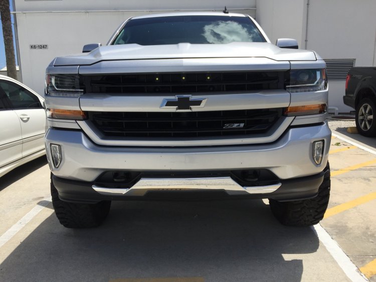

Light bar installed. Pain in the a$$. But can be done. Will post more step by step pics and tips
That looks really sweet. I finally have all my parts and hope to install it in a couple of weeks on my Sierra.
The RC light bar,  because it’s curved, sits hard on the middle vertical shutter rail and dips back into the shutters on the ends.  So I just trimmed them.  I don’t see why you couldn’t cut the last 2 out for cubes in the pic above. Blue tape is where I trimmed.  Just had to trim 1 shutter.  Cutting grille was a little tricky.  Cut the top of the vertical stems and followed the contour of the bottom edge with a drammel then sanded. Just kept fitting it on the truck and against the light and fine tuned where needed.  On the light end caps they stick up a little higher than the rest of the light so I notched out the grille on the top side for the light to sit flush with the top.  Sorry for the pics being sideways. I’ll post more pics later. Any other ? Just ask.
