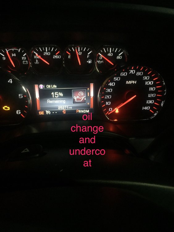

So with a bypass from anywhere of 12-22 psi, does that not seem low? My truck even when warm still hovers around 40 psi at idle. Does that mean I am bypassing my filter all of the time?? Excuse my ignorance, but this simply baffles me. BTW i just checked my maintenance picture log and I used the 10255 filter just this last weekend. IMG_0398.thumb.JPG.e1e70ce9f87113fba5bd1bc9c4605771.JPG

No, that isn't how it works.  The by-pass pressure is the delta P across the filter media.  When that pressure is exceeded then it will go into by-pass, like when you go WOT or when the filter gets loaded up.  The main reason they went to a higher by--pass is because of the new variable oil pump and system.  The filter was going into by-pass more often at a lower setting so they raised it.
So let me see if I am understanding this correctly. Let's just say the filter "fresh" is designed for 60 psi of continuous flow. If the filter degrades, or becomes restrictive over time and you go WOT and the oil pressure climbs the bypass is designed to open at 22 psi above the 60 psi design criteria. This reduces the chance of starving the engine of oil. Or am I still out there in left field?
