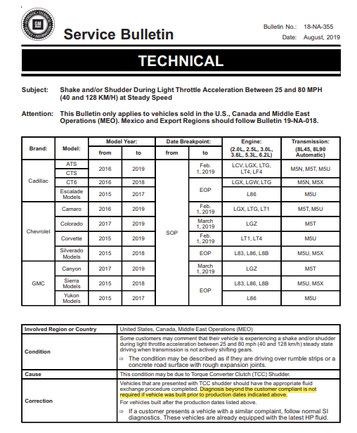

My Sierra is at the dealer today for the clunk and shutter. Of course they said they can't reproduce, so they asked to keep it overnight so they could drive it when cold in the morning. That's fine, but since it doesn't do it every time, they may not feel it. I asked if they could just apply the TSB and do the fluid change, but they said they have to be able to reproduce it. The bumper to bumper warranty is up in 1000 miles, would the powertrain warranty still cover me till the 60K if they don't do the fluid before the bumper to bumper is over?
Not true... Below is the TSB and clearly says diagnosis beyond the customer compliant is not required.  I would print the TSB and bring it with you and show them this then see if they will do it with out being able to reproduce it.  For what it's worth, I had the same clunks, harsh down shifts and then the TCC shudder. Once they did the fluid exchange all of that was gone. So far it's been about six months and no issues, drives like it should finally.  This was done under power train warranty after bumper to bumper had run out.
Thanks. I didn’t catch that in the TSB. I would have pushed back today when they said “we don’t just fix things we can’t reproduce.” If he tells me tomorrow the same thing I’ll point him to this. I brought the TSB this morning and he said he didn’t need it, that they would look up TSBs themselves and apply them as required.
