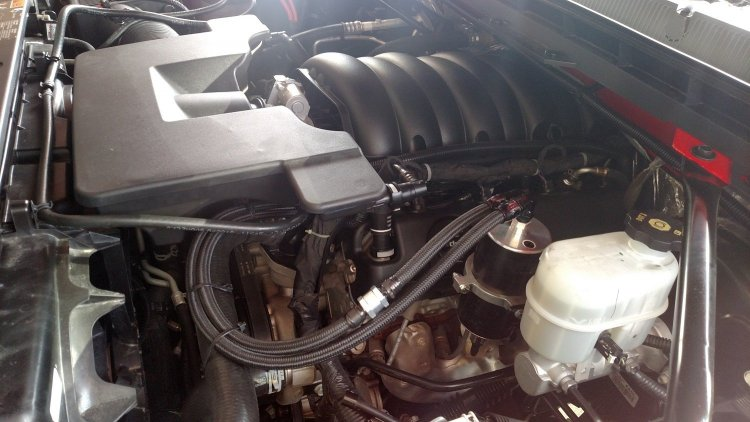

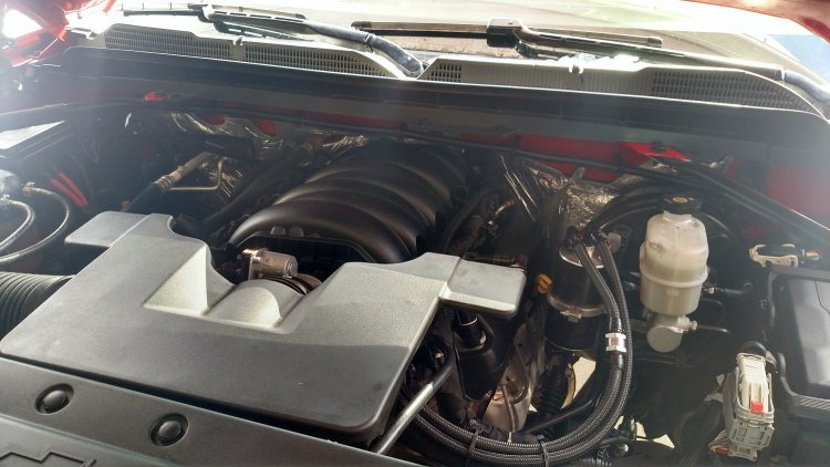

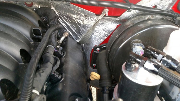

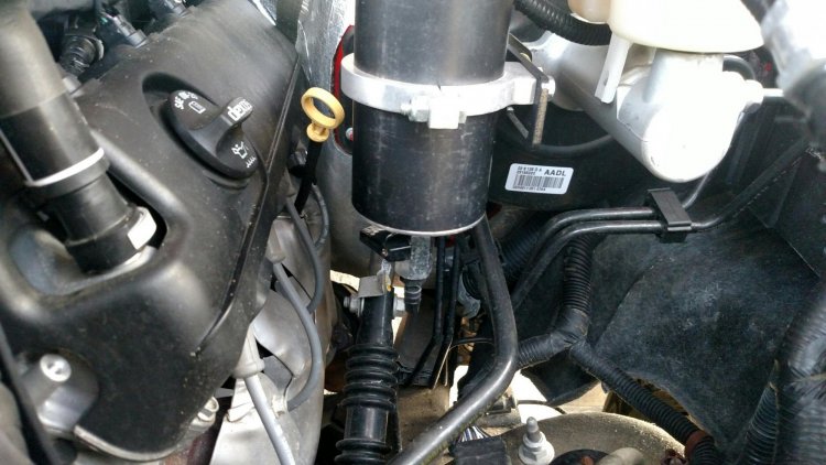

On 3/19/2018 at 4:07 PM, Mike GMC said:
Do you have adequate space under the can to access the drain and put something under it to collect the garbage coming out of it?  How does it affect access to the dipstick?
I added a few more pics. Still looks a little cramped in the pics, but it's really not. I can easily fit a standard water/pop bottle underneath the catch can for draining and accessing using the oil dipstick is also not an issue.
