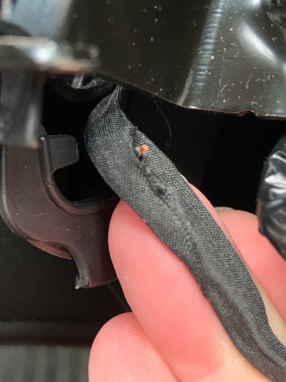

Thanks to LERBUD and some digging the problem is the wiring harness between the charging plate and the connector at the back of the console.
Unplugged the charger, replaced the fuse... sunroof works now!

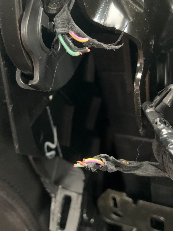

Same problem...  Noticed the green and black wires to the wireless charger are cut from the console hinge.  Fuses on the passenger side check out fine for the sunroof and sliding window but they still don't work.    Dealer says the charger is not on the same circuit and they want $450 to try and locate the short.
Figured it out.  Reread ZR's post - Corey the fuse is on the driver side panel - #2 - SEO RAP (10A).  That one was blown in my truck.  Replaced it and everything seems to work fine (except the charger is still unplugged but it wouldn't charge my phone anyway).

So I've been watching this post, Two weeks ago I bought a 2016 LTZ with power sunroof from a local dealer. After inspecting the truck I noticed that the power sunroof and power rear slider didn't work. The truck still has factory warranty till June of this year, so it's the dealers problem. There were a couple of issue's that I wanted fixed under warranty and they agreed and ordered the parts. So I pick my truck up two days ago and the dealer said it was all fixed including sunroof and slider. Before I get out of dealership my sunroof wont close and no power again to rear slider. It's after hours for tech shop so I leave it there inside and explain that the only thing I did after opening the sunroof is put stuff from rental back in my center console. I also mentioned this post that I've been reading, So with that info the tech confirmed the charging pad, sunroof, and power slider are on the same main feed. If you unplug the charging it will still blow main fuse because of a short in the wiring harness. You have to replace the harness or open it up and find the short. Thanks to this post the GM tech found the problem easily and quick. I can post the part # for the harness if anyone needs it.

Dr kadrock, sorry for the delay in response. Yes you have to go farther back on the harness and unplug to stop it from shorting to ground. Part number for the harness that needs to be replaced is 23124536 24800. Also the schematic document ID number that the tech used to identify the problem is #4232357. Hope this helps you.
