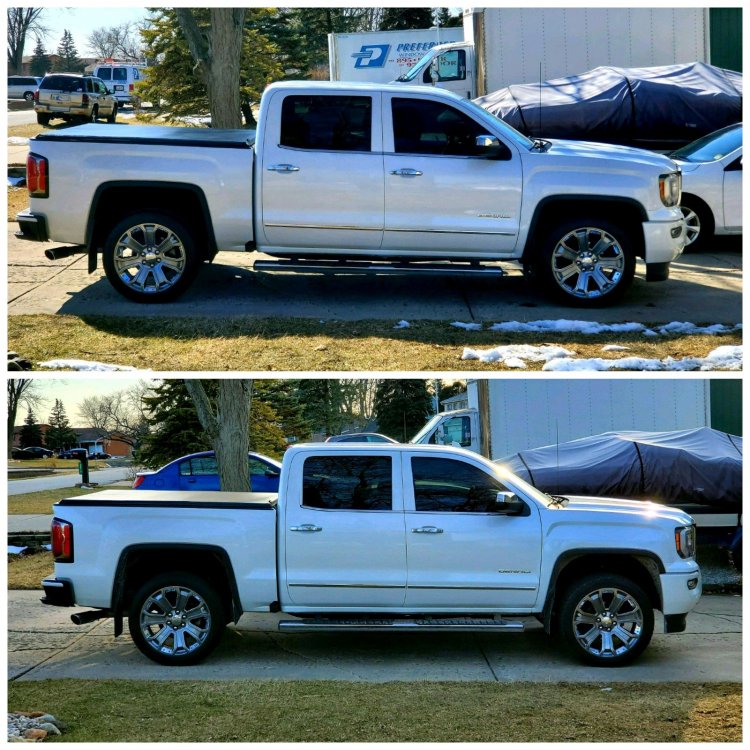

I just did a 2.25" SuspensionMaxx kit today and literally zero ride change. I ground down the bumpstops and yes I can see where the UCA may bottom out and clunk at full droop over a set of rough railroad tracks maybe. Otherwise, the ride with the magnetic ride relocation brackets is the exact same as stock. :shrug:
Truck looks good. Btw, you still stock?

Tires, you’re still stock or you going up in size?

I've got 37k on the stock Bridgestones, I'll probably run them til 50k. Love the look of 285/55/22 terra grappler g2's but I really dont want any rubbing and definitely dont want to have to do any trimming. So I may do 305/45/22 hankook dynapros which are a 33 instead of a 34 like the 285/55's.

The UCA is connected to the frame while the LCA is connected to the drivetrain. Any spacer lift that attaches to the strut makes the drivetrain and the frame geometry change by the thickness of the spacer.
It changes the geometry.
In my case (like yours), the ride and feel of the truck didn’t change.. other people have a different experience.
I attribute my ride consistency to the fact that I used 2” lift spacers made of urethane (actual thickness was about 1-1/4"), while most spacers are made of aluminum.
