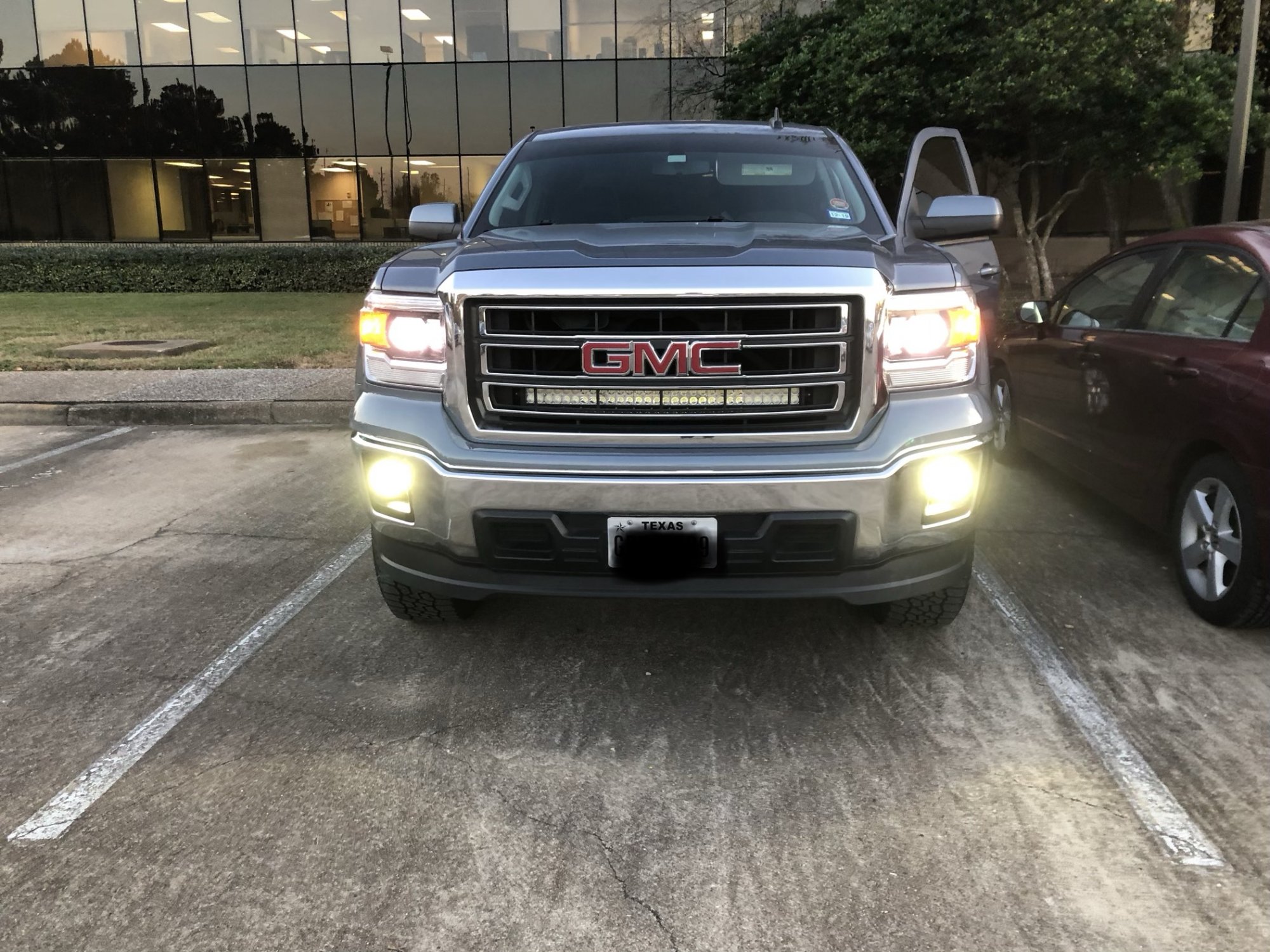

That looks 1000x better man and nice work on the deals you got for the parts. Did you buy a different color upper bumper pad and just take it to a paint shop for repaint?
Personally, I prefer the 2015 front end with squared grille round fogs. I do like the LED taillights better on the 16+ though. I am sure your lighting performance is twice as good as a 2015 though by going to the LED lights. I just put an HID kit, Morimoto LED fogs and 30" bar behind the grille like Texassggies to battle those problems. Nice truck in either spec OP.
Yes when I bought the bumper/grill for 750 he gave me a black upper pad that was is nearly perfect condition. So I had to get it repainted from black to my color but that was easy.
Thank you very much! I still am extremely glad I did the conversion. Could I have gotten away with my original lights all together? Yes but I dont know if I could own a vehicle without LEDS now LOL! I feel my truck looks better now, I am happier to drive it and I have yet to see one like it.
If you are patient on parts I think this conversion could be done even cheaper. Well Worth it for anyone not wanting to buy a new truck lol.
I dont have anything against the 14-15 front end minus the amber corners when can be cleared.. But I was just tired of aftermarket HID parts and was tired of messing with it. Honestly HIDS/leds in fogs and a light bar is PLENTY of light but im a bit of a perfectionist so I like the factory look of my full conversion along with all the LEDS matching.
I'm in the same boat, factory look is better 99% of the time, plus it will be better for resell as well whenever that time might come. I have the newer headlights on the way right now and I've been waiting on a good deal for a full bumper assembly to pop up and then I'll continue with the rest. The original front end doesn't look bad by any means so I'm willing to wait a good amount of time on each of the parts for the conversion, I just had to switch the headlights out now but we'll see what deals come up.
Edited by zoom
I would check your local facebook marketplace. I found my bumper on facebook the day i started looking!
