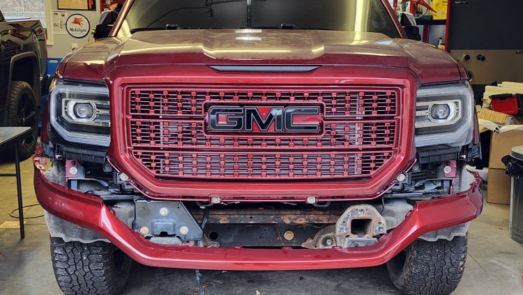

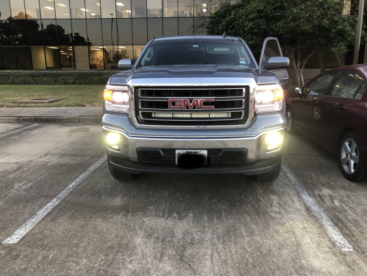

After some research I was unable to locate a thread on a 2016+ Sierra front conversion, so figured I would put one together for anyone interested! I know this conversion isn't for everyone due to resale value, costs, what the VIN says, and so fourth. Personally I love the iridium metallic and the options I have, so coming to terms with locating a 16 Iridium AT didn't make sense.  I began with the headlights a few months back due to the lack of light output on the stock 14-15 lights, after a bit of time the 16+ trucks began to grow on me more and more.
Let me start by saying..finding used 16-18 parts is challenging, the bumper being the hardest in my opinion. After a few months of sourcing parts, I was able to acquire everything at significant price differences over new. Minus the 16-18 headlights, the conversion cost me right around $1,800 said and done. Still having all the original 15 parts, I should be able to recoup a bit of that back. As for the 16+ Silverado conversion, more is required to be changed then the Sierra. From doing the swap I found that I needed less then I originally thought. As of right now I don't have working fogs, but that shouldn't be an issue. Unfortunately, the harness is on national back order.
Parts Required for Bumper Conversion (see pics below)
-Complete Bumper Assy (including brackets, fog lights, lower valance, harness)
-Upper Top Pad
-Sight Shield
-New Grille (Chrome, All Terrain, Denali..)
*Green boxes are required purchase parts
*Yellow boxes are optional purchase or modification of old part
*Red boxes are parts not needed
*You will have to locate 4 retainers for the grille, these are already pre drilled, As for everything else, it goes together like a breeze!
(16+ Headlight Conversion) please see post below:
(Bumper Assy) I didn't use either of the yellow items in the photo below, I trimmed the old side retainers down roughly 3mm
to accommodate new top pad:
(Wheel Moldings) As for the wheel moldings, I trimmed just shy of 1.5" on them and sanded down to save on costs:

2 hours ago, Andres Elizondo said:
WOW awesome job dude! What if i only want the grill and headlights of the 2018 on my 2014? Do I need to change to bumper too ao the grill can fit? Or it isn’t necessary? Thanks in advance!
The headlights will work on a 14-15 body style with a correct harness no problem. The link on that thread is up above. As for the grill, that will require the entire swap above as the 16-18 grill is larger than the older model.
