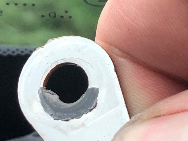

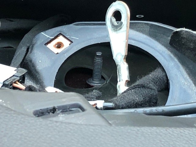

I had a similar issue with my wife's 2015 Silverado.  We checked the items listed in this TSB https://testing-public.carmd.com/Tsb/Download/112155/4318397   I found that the ground under the passenger side dash was the problem.  Its super easy to access with a screw driver and a 10MM socket.  Once under the dash i accessed the ground studs by removing the tweeters on both sides.  In my case I could clearly see that the ground wire had rubber stuck on it and was likely the culprit so don't forget to clean all ground contacts!!! terminals and studs.  Problem solved.  Good luck with yours if this is your issue.
