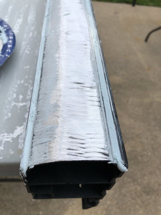

Thank You! I did a Raptor bed liner spray kit on them.
2 kits actually, since I screwed the 1st kit up on my 4th bottle! haha. Tried to fix a spot while it was wet. BAD IDEA!
I also peeled the chrome off, which then left 2 channels on the top and bottom of the running board that I filled in with bondo. Then sanded all and coated. But now, since I took the chrome off, the end caps have a little gap in them.
Bed liner spray doesn't stick to chrome well and I didn't want it to bubble like my front mustache piece did when I bed liner sprayed over the chrome. Within 6 months I had to scrap it off and grind all the chrome off (down to grey plastic) and then redo the bed liner spray.

Also, can anyone confirm that these are fully functional in a double cab once retrofit? I’ve only seen crew cabs
Fully functional, but you have to modify the boards to physically fit. 9019633be40e473d96365a26e8802a31.jpg
