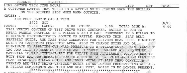

I have the distinct metal ticking that the OP has - no vibrations.  Mine is on both sides of the truck in the B pillar and more recently, under the driver's door speaker - clearly coming from something in the metal under the actual door or dealing with the hinges that connect to the body.  I've had all the panels off, padded everything (literally done everything since I got the truck a year ago except spray foam like the Colorado owner suggested.  The dealer has torqued every bolt except the ones that require you to take the front fender off on the driver's door.  The other funky thing is that when I work the back doors of my crew cab back and forth once it gets hot out, I hear a clicking coming from the metal near the b pillar.  If I squeeze the frame with my hand about 2 inches in from where the b pillar metal turns into the door frame in the back doors, the noise temporarily goes away as I work the door back and forth.  I have a few youtube videos up showing all this that I'm happy to link here if it helps anyone... but so far, I'm at a complete standstill.

This is at the core of the issue for me. The noise is coming from a flexing of a body panel. The sidesteps simply act as a lever arm on the body panel and cause it to flex more dramatically. Removing the side steps doesn't fix the root cause but has certainly eliminated the symptom.
