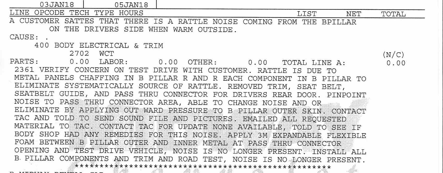

It appears as though my problem with the issue may finally be resolved. I attached service notes from the dealer. But in a nutshell: Near the B pillar pass through connector, there are two pieces of sheet metal sandwiched together that were causing the rattle. There should be a small amount of space between the two pieces, but there wasn't enough. Which is probably why I only heard the noise during warmer weather, as heat causes expansion. The techs at the body shop injected some 3M foam in the area of the B-pillar pass through to eliminate the two pieces contacting each other.
Thank you for posting this. Its cold now so this annoying noise has slipped my mind. Come summer I will be removing the panels to see if I can locate what the technicians were talking about in the repair order.
So glad you posted this.  I was having this issue but since it has gotten colder lately the dealer could not reproduce the noise and had no idea what to do.   So instead of waiting until spring and hoping they could hear it then I sent them your print out and they did exactly the same thing.  Time will tell if it worked for sure or not, but at least they did something and didnt just tell me I was crazy :)    I also had the rattle in the dash going on and they took my entire center console and dash apart and found 2 bolts that were not tight.   So hopefully now all my random noises are done.
Anyone know how to remove the trim to get access to the inside of the b pillar?  Some instructions would be greatly appreciated!
Update: Got the pillar off.  Definitely coming from the rectangular cut out where the wire harness goes to the door. The post about the two pieces of metal is spot on.  Now I’m just hoping my dealer will do the same thing.
