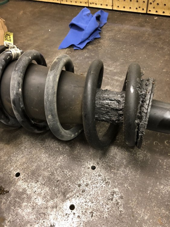

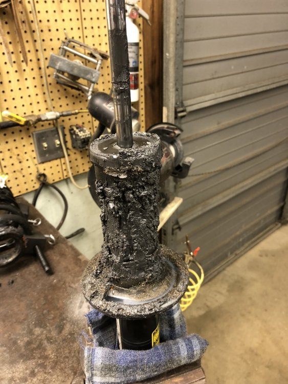

The Magneride struts on my 2015 Sierra Denali leaked all the fluid out at 40k miles.  Dealership refused to work with me at all and wanted $3500 to replace just the front struts.  I'm getting them replaced at Firestone for around $800 with a lifetime warranty.  Not worth the fight with the dealer.  I'll let you know how the aftermarket product works.
10/25/18 update: So, I wasn't informed that Firestone was going to put Rancho replacement struts on and bypass the magneride system.  I declined that option and had them put on new OEM struts fo r$1700.  Rides great now, but ouch!
