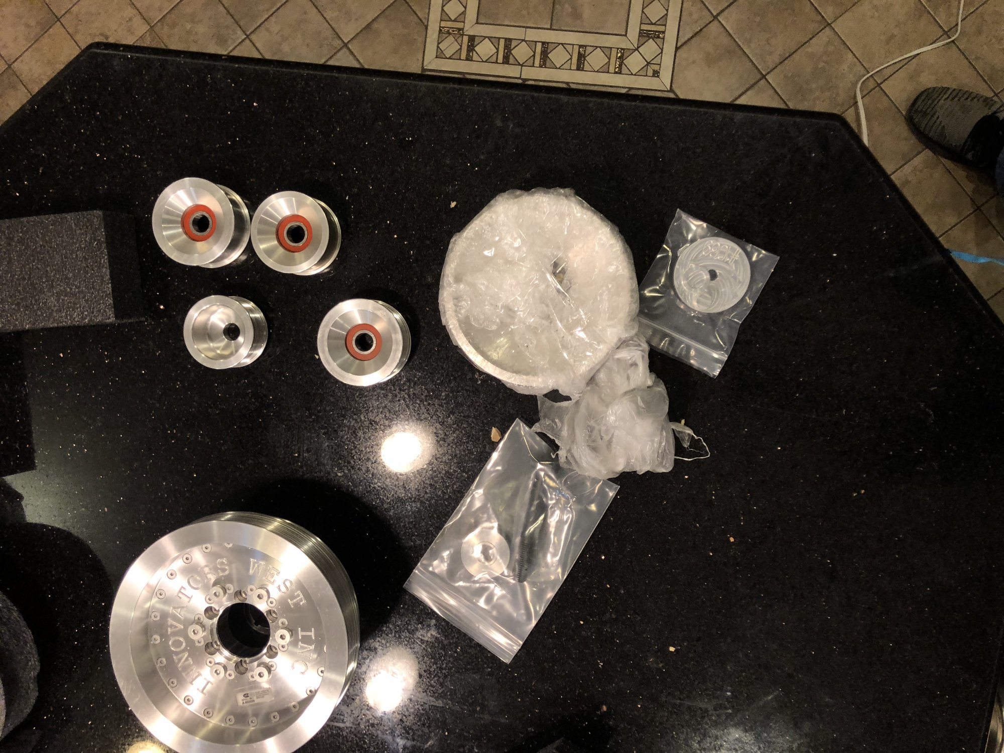

Well just to give an update I have the first complete  set of 8 rib pulleys coming from innovators West.  Plus three more iw pulleys to replace the 6 rib idlers on my whipples idler bracket.  Also got a 3.00 inch griptec’d pulley from weapon x.  Will post pics of the install and my review as soon as I can get them installed.  Thanks for everyone’s support!
