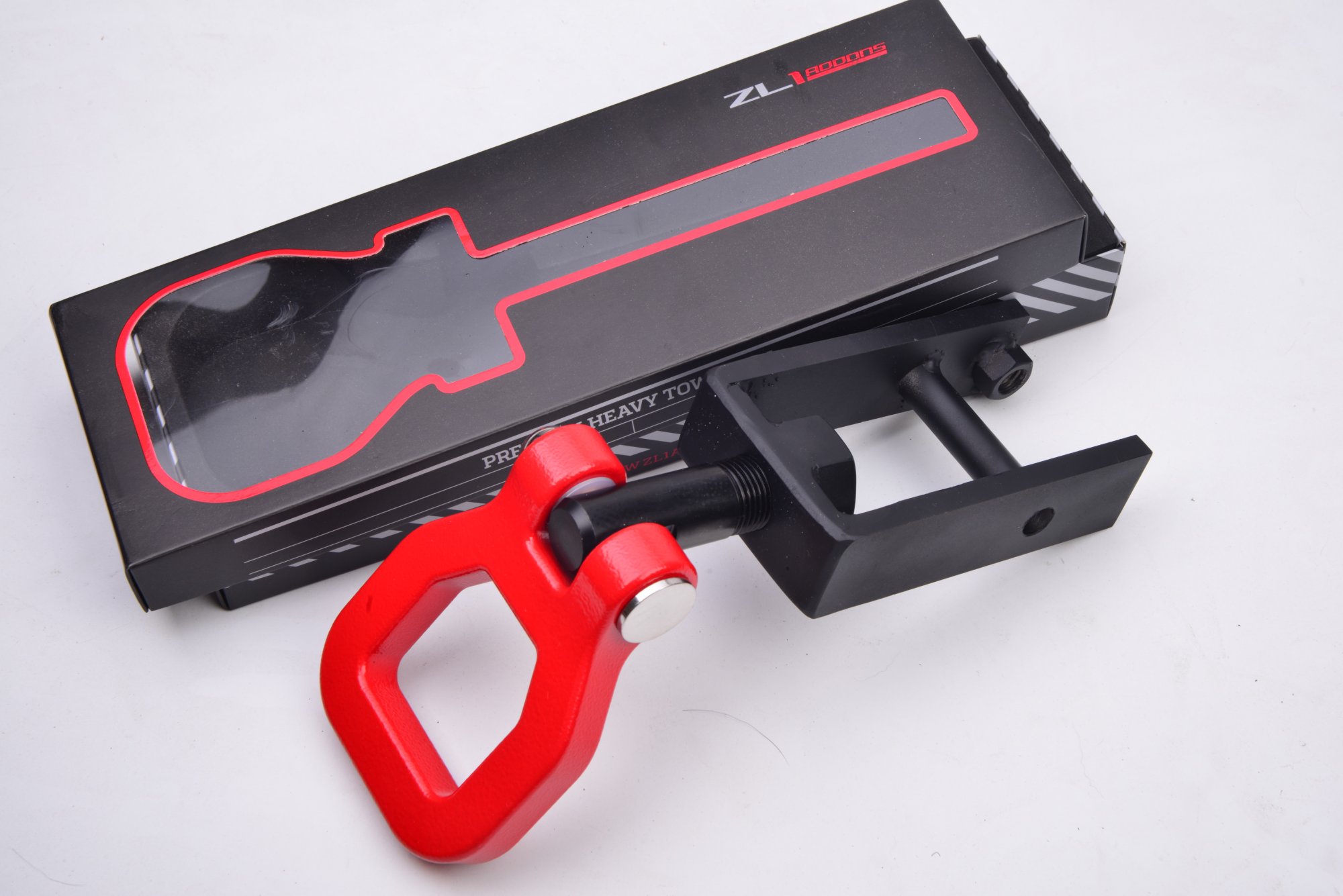

We have receivers and the new big D tow hook for the 2005 to 2017 4x4 trucks, they will also fit the 2 wheel drive with a cut out. We are becoming a vendor on this site if we ever hear back from them. They come with the receiver you swap out with the existing d ring.  tow hooks can be unscrewed from receiver if needed.   www.zl1addons.com

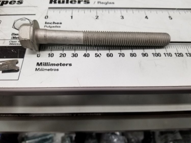

Anyway you can tell me the stats on the bolt head to install the hooks?  I'd like to pick up two from HD (my truck is a 2WD) since I'm buying my recovery hooks on CL.

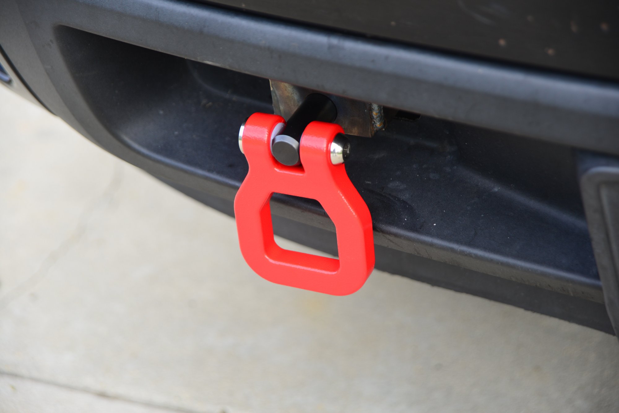

I just installed red tow hooks on my 2017 z71 silverado. I used a sawzall to cut the head off the head of the bolt off on the driver side. Slide the bolt out until it touched the bracket and held the head with a pair of vise grips and cut the bolt. Was a piece of cake.

Very easy to install, just remove the OEM stock hook and ours bolt right in its place, for the non 4x4 they will fit also just drill a 1 inch hole though the plastic cover and NO NEED TO MODIFY OR REMOVE BUMPER. All the frames of the trucks have existing holes for the tow hook receivers. if you look under the bumper you will see you can get to the frame to install them.
