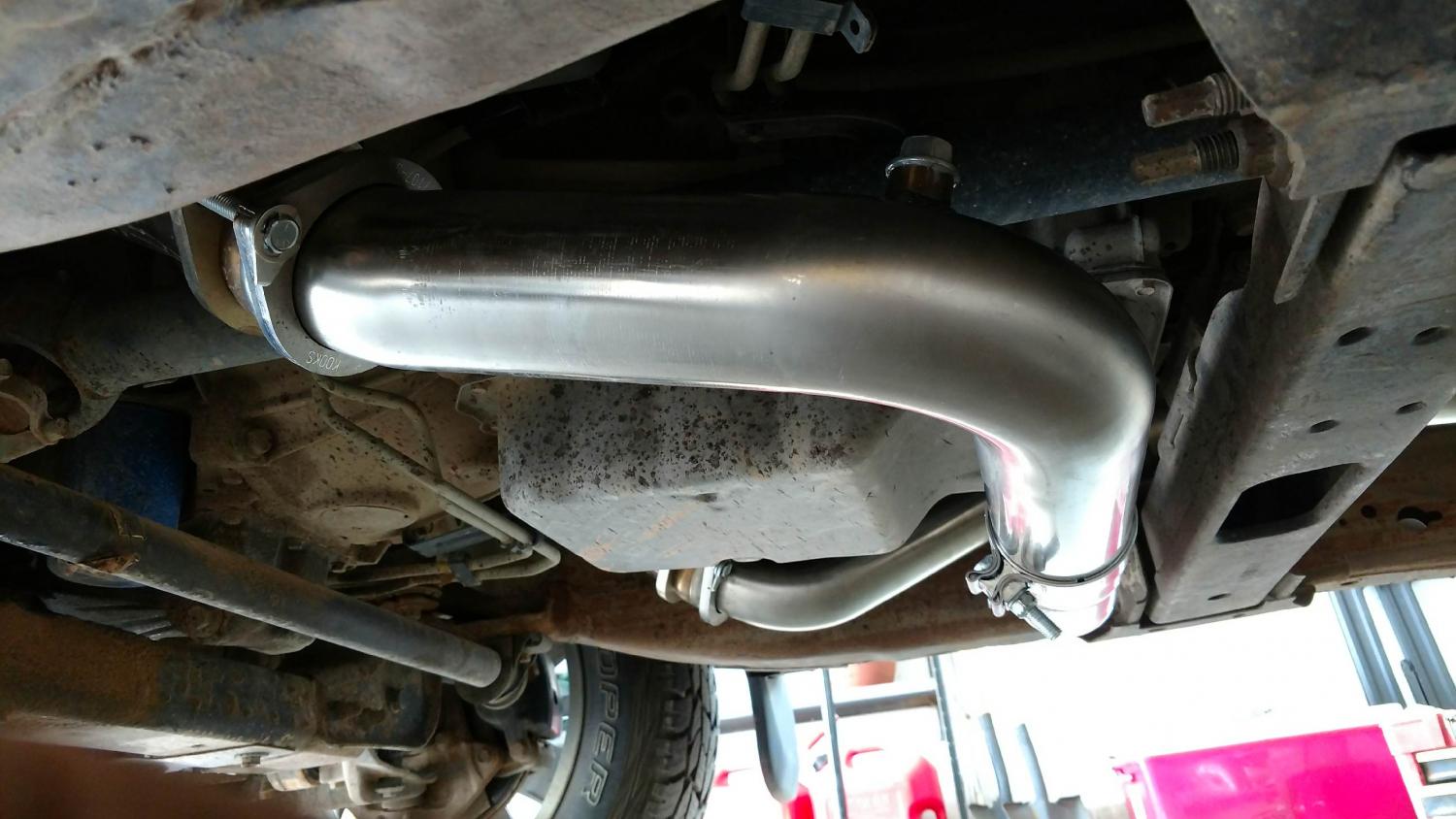

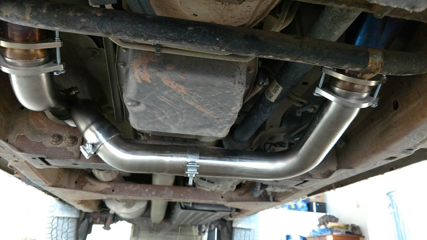

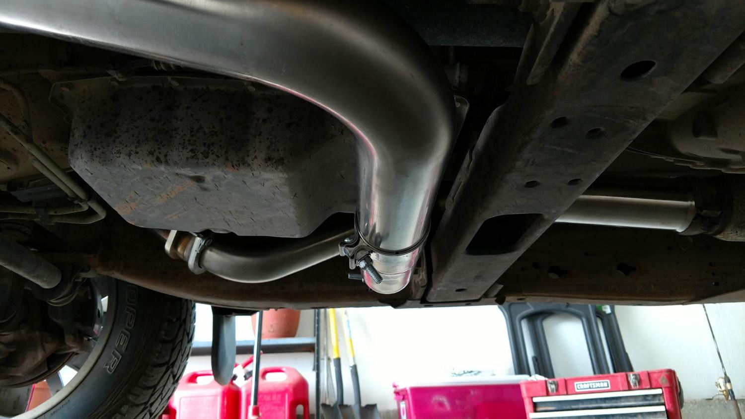

Finally got around to installing the Kooks y this afternoon. Looks like to drop the trans pan you can get away with taking the drivers side off where it connects to the header and the clamp off where the crossover pipe connects to the passenger side.
Good to know, thank you for the pictures, looks like it would be much easier to deal with.
