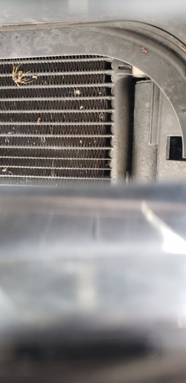

I have a 2015 LTZ Z71 with 41,100 miles and seems like I am leaking refrigerant from the condenser. Really sad that this truck is having these kinda issues and of course, no help from the dealership. Warranty expired May of 201920190827_181648.thumb.jpg.05d2435b81b21ff5d766bb8cf9fd7665.jpg
Sorry to confirm your suspicion, but yes yours is leaking.
If mechanically inclined you can replace yourself for under $200 including new refrigerant.

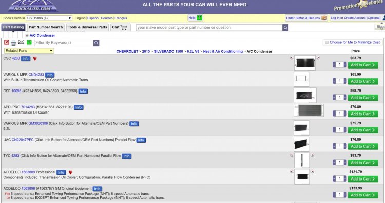

Mine gave up at 63,000. I ordered a new condenser off Rock Auto for $80. The hardest part about replacing the condenser is getting at all the bolts that hold the bracket at the top of rad and condenser. The rest was pretty damn easy. Borrowed gauges, vacuum pump, a jug of r134a from a guy I work with and charged the system back up. Running good now. No way would I oay ANYONE $1400 for this repair.
