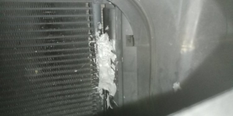

20 hours ago, Sierra Dan said:
$45 for a tube of JB weld? :D
