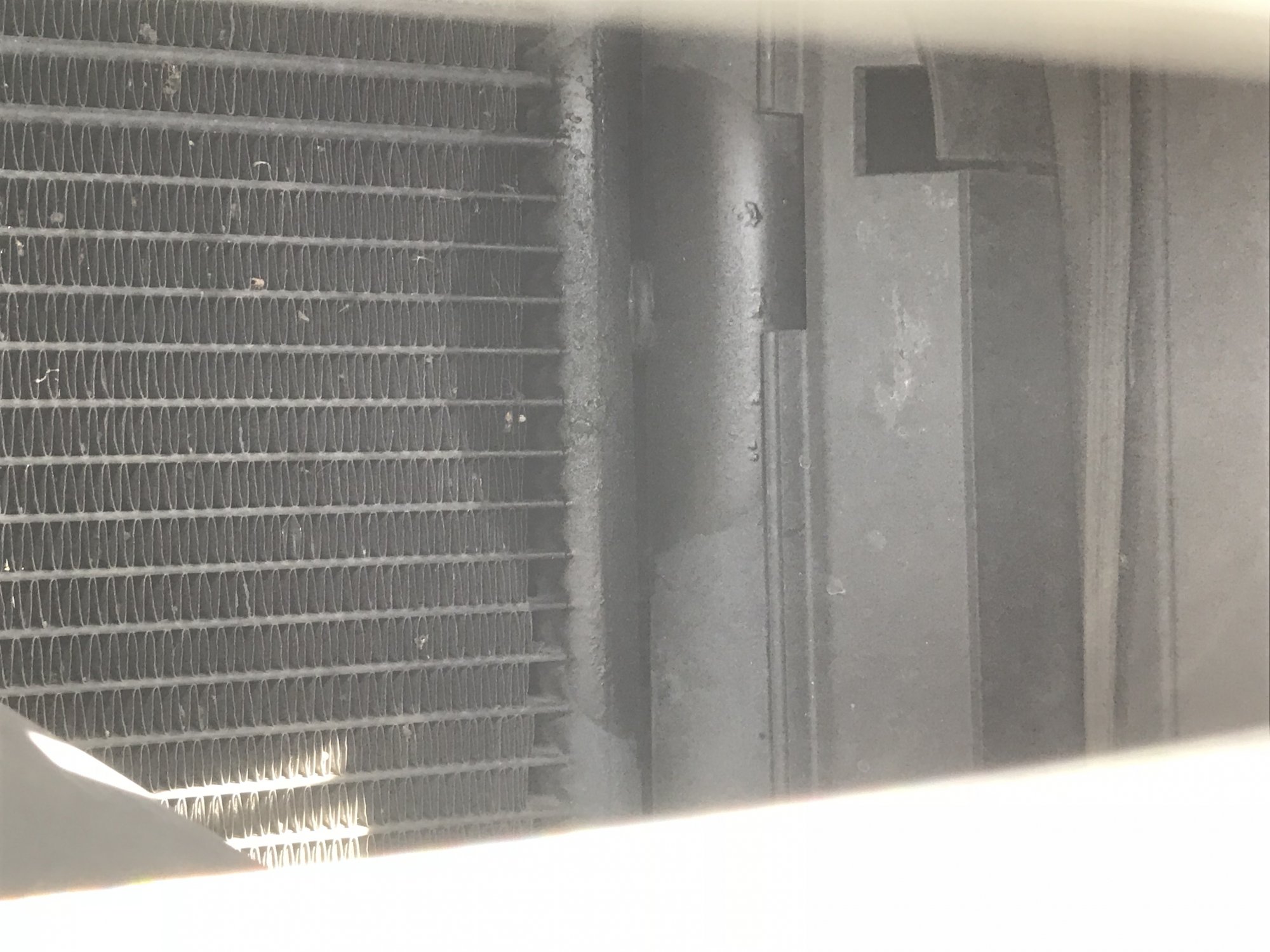

Add me to the list. 97k miles and A/C started struggling to blow cold air. I checked condenser and sure enough, leaking from the same spot as everyone else.
I'm not even going to attempt to ask dealer with 97k miles. I'll be changing it out myself this weekend.
