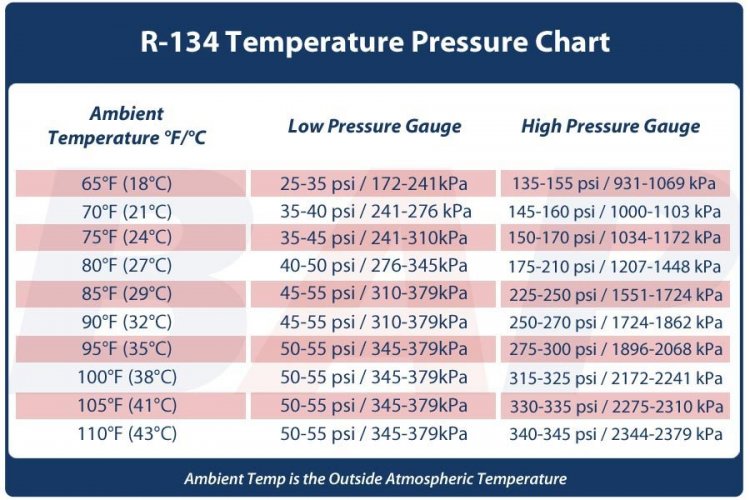

Flawed or not, higher temps cause the AC system pressures to dramatically go up.  The condenser is on the "high side" of the system.  At 113F, the pressures would be around 350 psi in the condenser, compared with around 250 psi at 85-90F.  AC refrigerants are highly temperature reactive.
