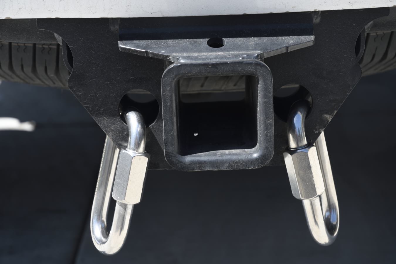

Thanks for the pics and hook info. I can see why your setup works easily. The holes in your hitch are way bigger than on mine. That's been the trick. Finding something small enough, yet strong enough, to fit.
Here is a 13. Up and out. Not sure if new hitch is any different.
Yup, very different. The "up" holes (in your pic) in the 16 are about the diameter of a pencil. The holes on either side of the receiver are also smaller.
Believe me, if it had been as simple as your pic makes it look, I wouldn't be asking for ideas.
I used two 5/8" quick links from Tulsa Chain, rated for 8,100 pounds each. I then attached an eye bolt through the bottom of the hitch to hook up the safety brake cable (this idea was from forum member jhplak325).
Yeah, it looks like I'll be going with the 5/8" links too. The eyebolt is an interesting idea for the brake cable. Does the safety cable just slide through the slight open end of the eyebolt?

Got my new quick links installed. I think I'm going to like this better than the other setup.
Trailer is at the dealer for some warranty work so I'll be giving these a try when going to pick it up.
