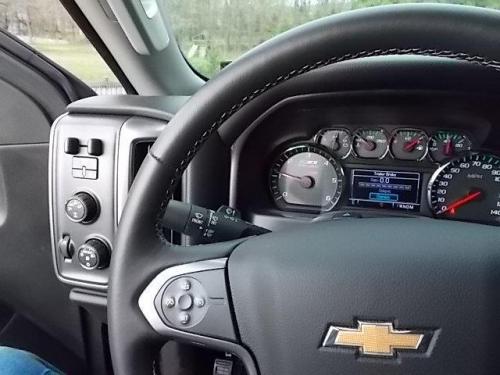

From what others have stated it is not possible to add the JL1 factory trailer brake controller if the truck does not come with it. If you want a quality brake controller get a Tekonsha P3 and put it in the pocket where OE one goes. Here is a picture
http://www.gm-trucks.com/forums/uploads/monthly_12_2015/post-127843-0-77143200-1448998330.jpg
Edited by Lgetz
I don't know about you, but the placement of that brake controller is just hideous and sticks way out. Under the dash would be a better spot.
May work for some but longer legged people might bang their knees with it. If I did more towing buying a truck with JL1 option is a no brainer. Right now it is a non issue.
May work for some but longer legged people might bang their knees with it. ...........
X 2 - Banged my knees on a Prodigy for 10 years in my 2007.5 .......... Never again would I own a rig without a built in controller were it is up in a safer place for use. Same for back up camera..... makes hooking up sooooo much easier..........
