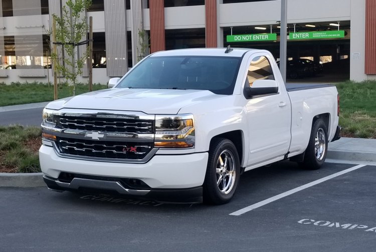

The qa1 shocks in the rear are great. I'm still messing with them but I'm liking setting 3 and 4. And I prefer a somewhat firm ride.  I woiuks recommnd them.  The only modification I'd grinding down the lower shock mount a hair so the shock body doesn't rub on it
18 minutes ago, Grumpy Bear said:
May I ask why you wanted them upside down? I think I know but.....
Easier to adjust them    and grinding the lower mount is easier than grinding the upper mount

The whole light is different compared to an LT light. Plus they are LED
11 minutes ago, Grumpy Bear said:
Is that plug and play? Sounds interesting.
Yes and no.  I had to get an ltz light harness. And pgamboas resistor harness. You need parts but it's all plug and play    way betterthan the LT lights
