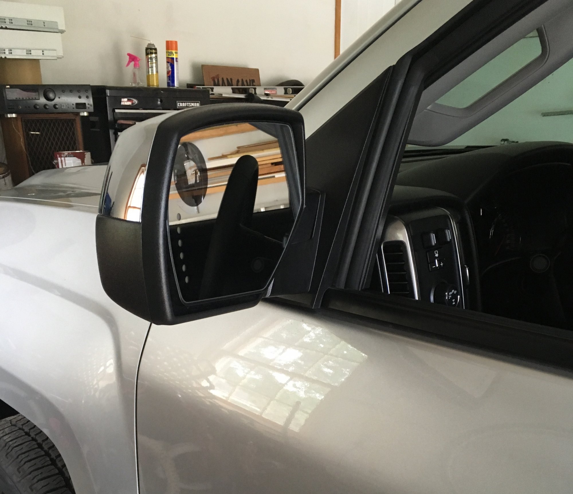

@pgamboa  I just wanted to give credit to Phil for his help, support, awesome product, and great videos. I was able to convert my DL8 mirrors to DL3s.  I can recommend to anyone thinking on trying this to shoot Phil a pm and get his harnasses. Take your time and be patient as you go. I also had a little difficulty initially getting the panel to release from the upper clips, but it worked out with a little more effort.  Once again...thanks Phil.
