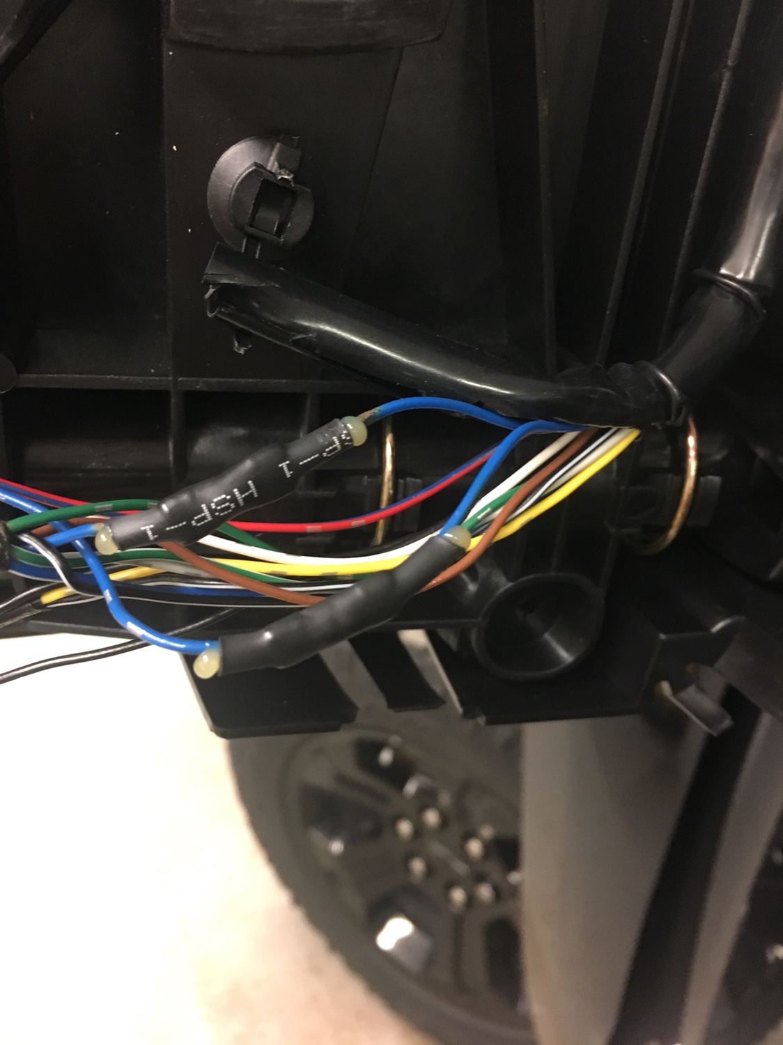

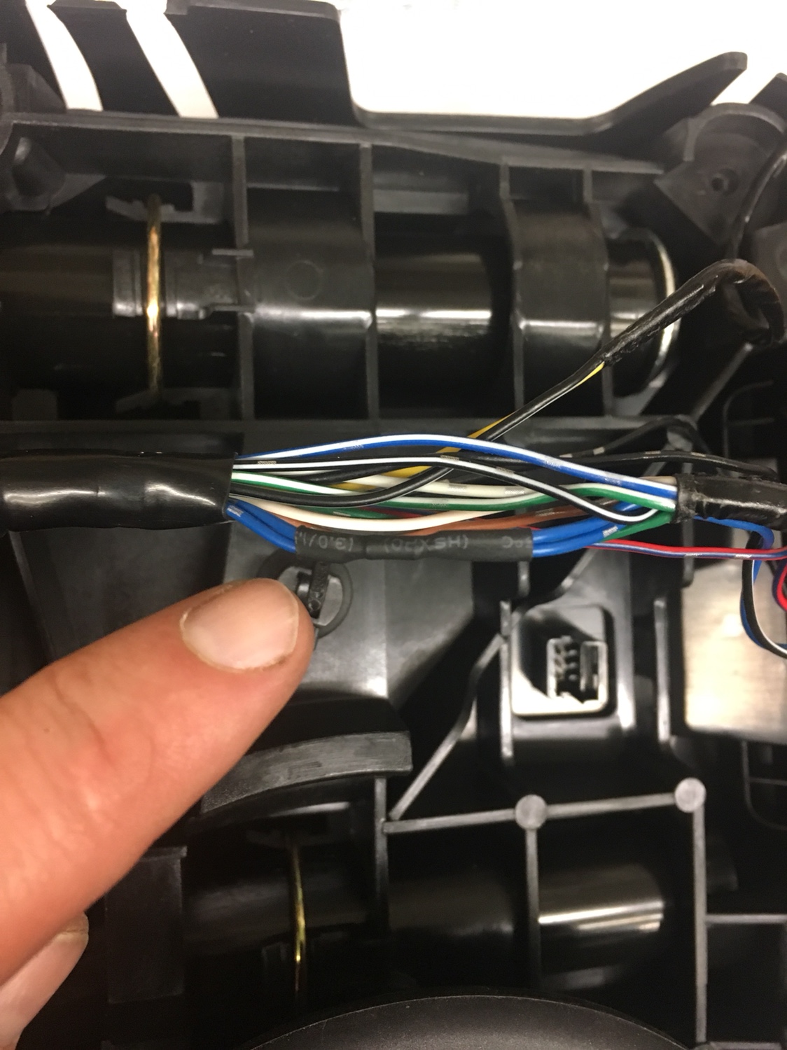

I had the same problem as you guys with the 1AMRP01786 tow mirrors and just fixed mine…I have 2017 silverado crew cab 1500 ltz. Just got my new tow mirrors 1AMRP01786 and got diy kit from phill. Installed everything and blew fuse 29…took mirror apart to check and found running lights pin #1and power fold pin #4 are crimped together inside mirror causing short when power mirror switch plugged in…I cut out the crimp and wired the two wires separately. Replaced fuse and plugged everything back in and it’s all working good nowIMG_4951.JPG48ace9eae6e7c181e27c32cad50626fe.jpgIMG_4953.JPG
I had the same problem as you guys with the 1AMRP01786 tow mirrors and just fixed mine…I have 2017 silverado crew cab 1500 ltz. Just got my new tow mirrors 1AMRP01786 and got diy kit from phill. Installed everything and blew fuse 29…took mirror apart to check and found running lights pin #1and power fold pin #4 are crimped together inside mirror causing short when power mirror switch plugged in…I cut out the crimp and wired the two wires separately. Replaced fuse and plugged everything back in and it’s all working good nowIMG_4951.thumb.JPG.83f57b445a45704825fc231c7282f9a2.JPG48ace9eae6e7c181e27c32cad50626fe.jpgIMG_4953.thumb.JPG.170272ad0e9d44825d8e5e28f174989e.JPG
This is located behind convex mirror

THANK YOU very much for diving into this and finding the issue! With your permission, I’d like to share your photos with the manufacture in hopes they can quickly make a revision change. Obviously, it’ll take a while before this update can happen, but better sooner than later, and thanks to you, we can share this with the manufacture.
I have had open dialogue with the manufacture and have provided feedback like this so that they can improve.
Many thanks again!
@nick_99chevy
Can you also confirm that all functionality like power adjust, power fold, memory features, and all lighting features are completely restored and functional with this fix?
Thanks,
Phil
The more I think about this the more irritated I become. I can see no reason for this splice but to purposely induce a short when both options are used simultaneously.  When this first started happening I called 1A-auto to inquire with one of the Technicians. I had already narrowed it down to a short in the mirror. I just never figured the short would have been intentional. I hope I'm wrong but when it quacks like a duck....
