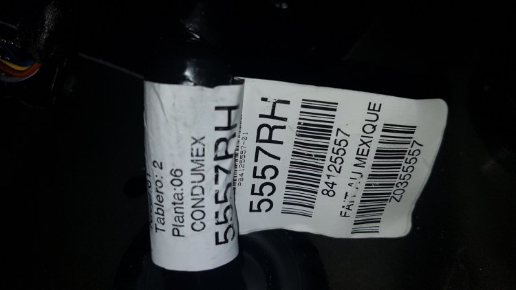

First post on this site. Love the info! I'm upgrading my 17 sierra to tow mirrors. Anyone know where I can get a pinout diagram for the harness in the attached picture? Thanks in advance!
-Matt
GMupfitter.com
  • Thanks 1
