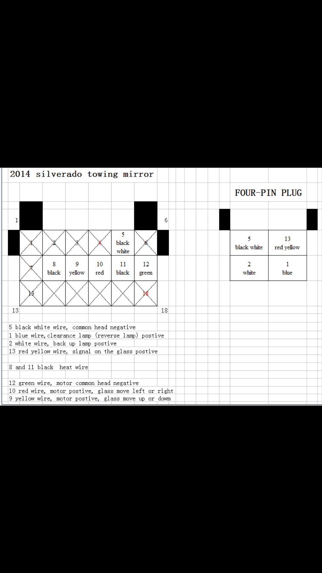

I have an 2016 Chevy Silverado 1500 Custom/WT truck. I have the basic defrost and power mirrors. I just bought some tow mirrors by Syppo online from Ebay. These new tow mirrors came equip with:
New 2015 Design Chevy Towing Mirror, Custom Made fits Models
Power Operate Adjusted: Yes
Heated: Yes
Turn Signal: Yes.( On glass )
Power Extended: No
Power Folding: No
Memory: No
Clearance Lamp: Yes. ( on the back of mirrors). Buyer needs to do own wiring. Wire included, no instruction with mirrors.
Backup Lamp: Yes. Buyer needs to do own wiring. Wire included, no instruction with mirrors.
Color: TEXTURED BLACK
I've installed the mirrors on my truck myself but the none of the lights works.  Do you have info or a special harness that I can purchase to make these tow mirrors fully function and work? I would like to have my turn signals on mirrors, backup lights and clearance lights working. Please respond to this post or email me at [email protected]. Thank you

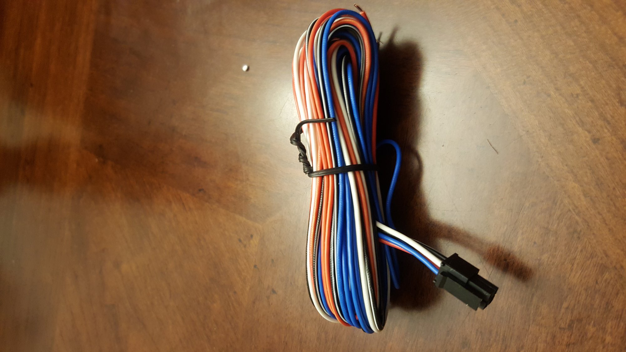

It came with an harness, but my truck wasn't equip with turn signals before buying these tow mirrors, I heard I may need additional wire harness and have my vehicle flashed. Syppo didn't have instructions converting over. I'm basically going from a DL8 mirrors and would like to convert to a DPN tow mirrors.
Yup. I sent ya a PM about this. The extra connector is for the lighting system. If you can send a pic of the front of the connector so I can see the pins and connector layout.
This will be 2-steps for you. Are you looking for Plug and Play or DIY?
