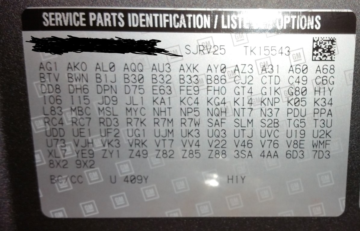

I've got a quick question. I have a 2015 SLE (1500) NHT with DPN.
From all I can see after 2 years of winter use in Canada, these are not heated. I know my build sheet shows heated mirrors, but then the NHT package replaces them and it also does not mention heat.
I'd like heat and power fold as well as everything I have now. Puddle lights would be a nice addition as well. Is this doable?
If I knew how to attach pictures, I'd give the RPO codes.

I haven't heard of an OEM Mirror that wasn't heated. The heating element is on the same circuit as your rear window defogger. So in order to get them to heat, you need to have the rear window defogger activated.
If you are able to, pin #8 on the mirror connector is the heating element. If the mirror is not heated, this pin would be missing.
As for mirrors, GM OEM Tow Mirrors do not have a puddle lamp. Instead, they have a Cargo Lamp (Shines rearward) for increased visibility when reversing, and a park lamp (Shines forward) as a marker/clearance lamp, and of course, a turn Signal.
There is one aftermarket mirror that these features AND a puddle lamp. This mirror is from 1A Auto - Part # 1AMRP01786.
