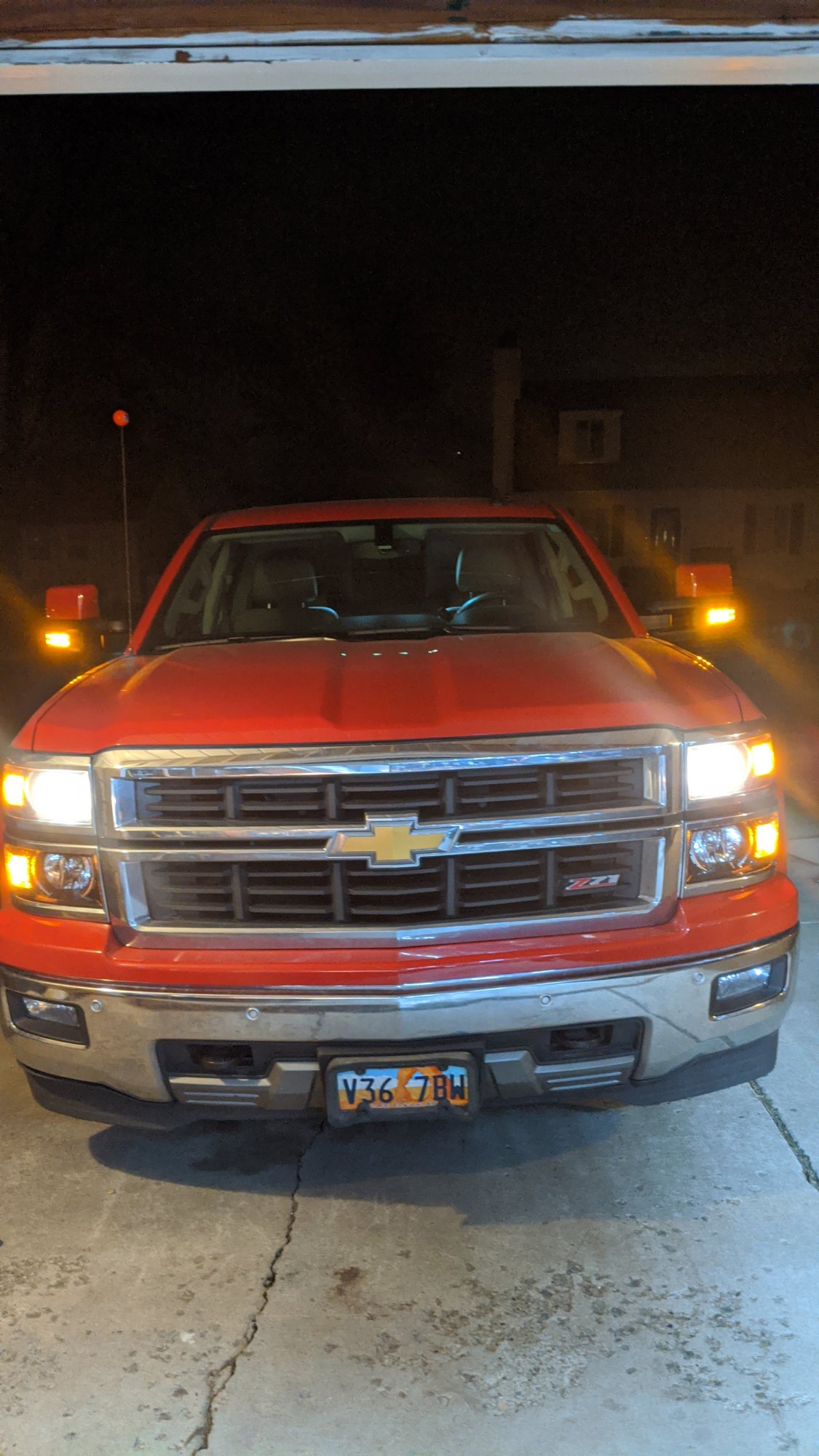

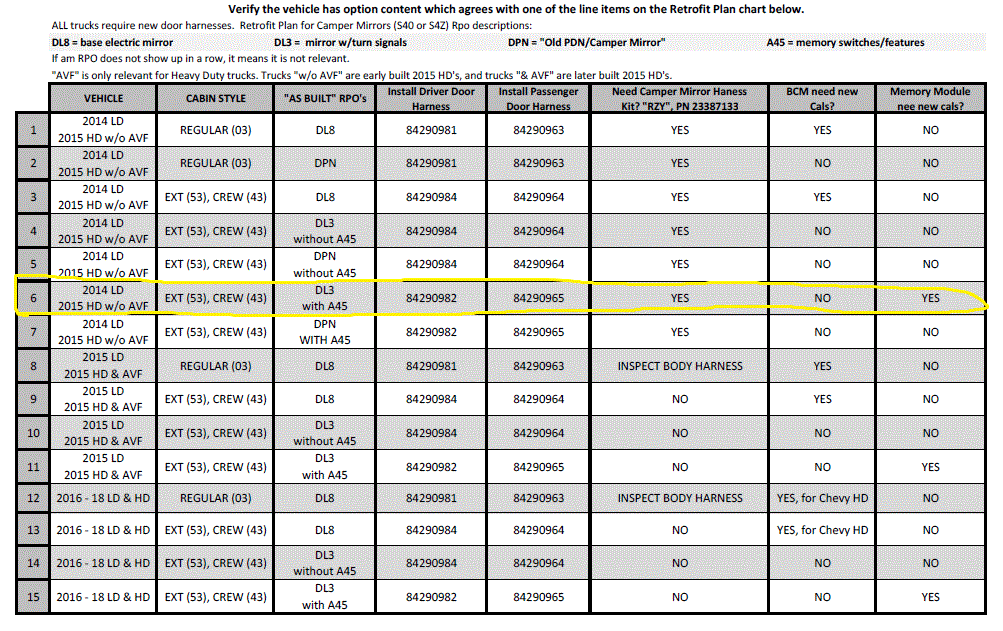

I did the GM approved DL3 => DQS mirror upgrade today on my 2014 LTZ 1500. The RZY harness was a pain & took more time to install than both mirrors combined. At the end of the day, all mirror features still work (adjust, power fold, reverse tilt, cargo light, park lanp), except I can no longer update my mirror/seat memory profiles. The dealership I bought the mirrors from sent me a code for a BCM update, I'll have to look into that on Monday. Does anyone have more information on that? Something I can tell my local dealer besides, "this code, BCM, Mirrors, go"?
Edited by Wesley Christensen
On 3/1/2020 at 12:16 AM, Wesley Christensen said:
Just wanted to put this out here in case it helps anyone out.
Can you provide more detail on this?  What part of the memory system is not working?  Be as specific as possible...what works, what doesn't work?  Does reverse tilt work?  Does key fob fold work?  Can you set seat/mirror positions, then recall them?
Did you swap the door harnesses as well?  If so, what part # harness did you use?
@pgamboa The only thing that doesn't work is saving new "profiles", Reverse tilt does work. Power adjust seats & mirrors still work, Power folding works (key fob & button). even pressing the "1" or "2" buttons causes the mirrors/seats to return to the saved positions. Yes I did swap out the harnesses, the right hand was P/N: RH84390965 (RH965RH) I'll have to pull the door panel to get the Left Hand P/N....Interesting development. The dealer told me they called GMs technical center & they were told there is no way update the BCM for tow mirrors on 1500 trucks...?‍♂️
