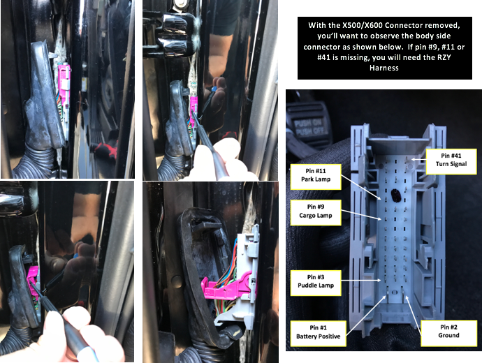

Since your truck is a 2015, you'll want to inspect your door jamb connector harness.  You want to see if in the door jamb/cabin side of the connector, pins 9 and 11 are present.  This will tell us if the cargo light (white rearward shining light) and the amber running light circuits were ran to the door jambs.
You will need either to swap door harnesses OR modify your factory ones.  We have products to support either option you choose at our site - www.HarnessDR.com
