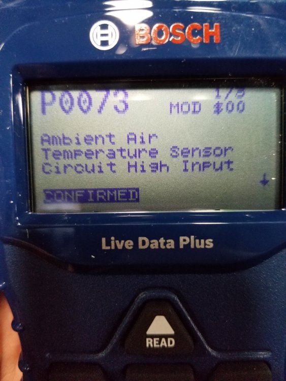

Alright so I purchased boost auto old style mirror with the sensor. Now I'm getting a ambiant temp code after install
Have you tried clearing the error?
