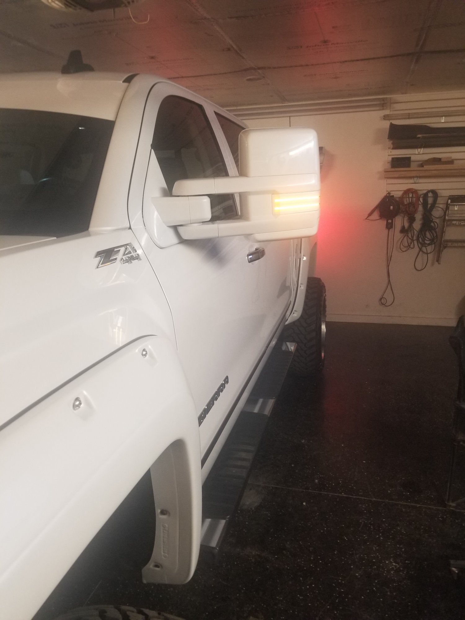

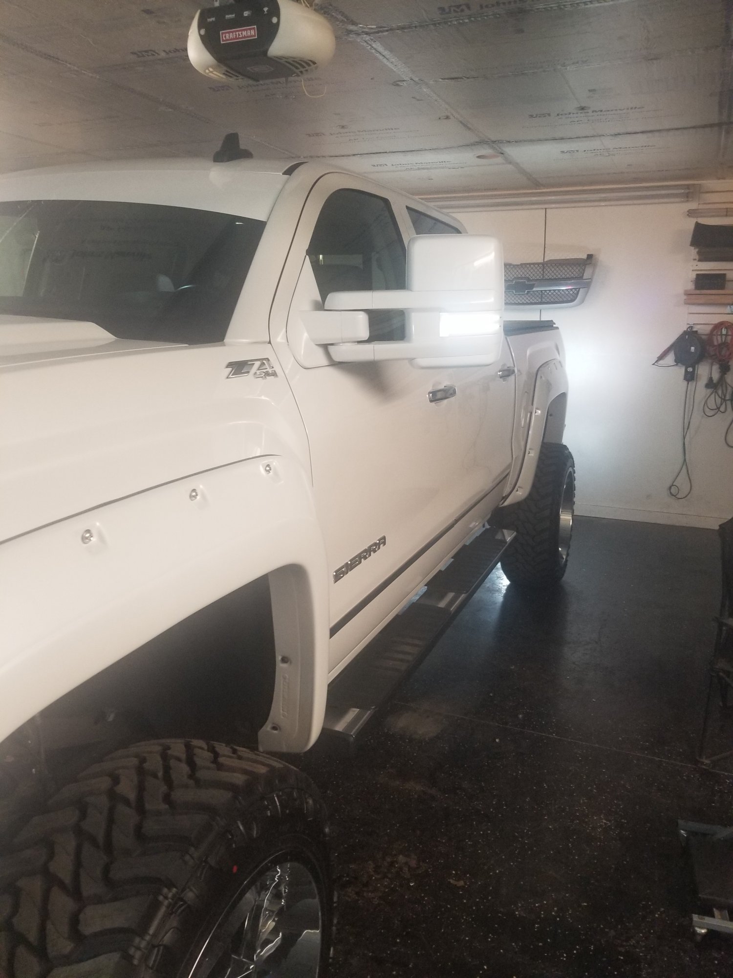

For anyone looking to upgrade their factory mirrors, I definitely recommend ordering harnesses from pgamboa. I recently finished replacing my dl3 mirrors with dqs tow mirrors on my 16 Sierra. The harnesses I received were of excellent quality and truly made the install plug and play and he even included diodes and instructions to make the cargo lights work as reverse lights.
That is a very sharp truck.  I have a few questions, if I may.  I assume the cargo to reverse lights mod on the mirrors is the same trick that turns the bed cargo lights on when the reverse lights are illuminated?  Who did the running lights/switchbacks for you, or if you did it yourself, where did you get the lights?  Thanks!
Yes - Same diode mod method.
