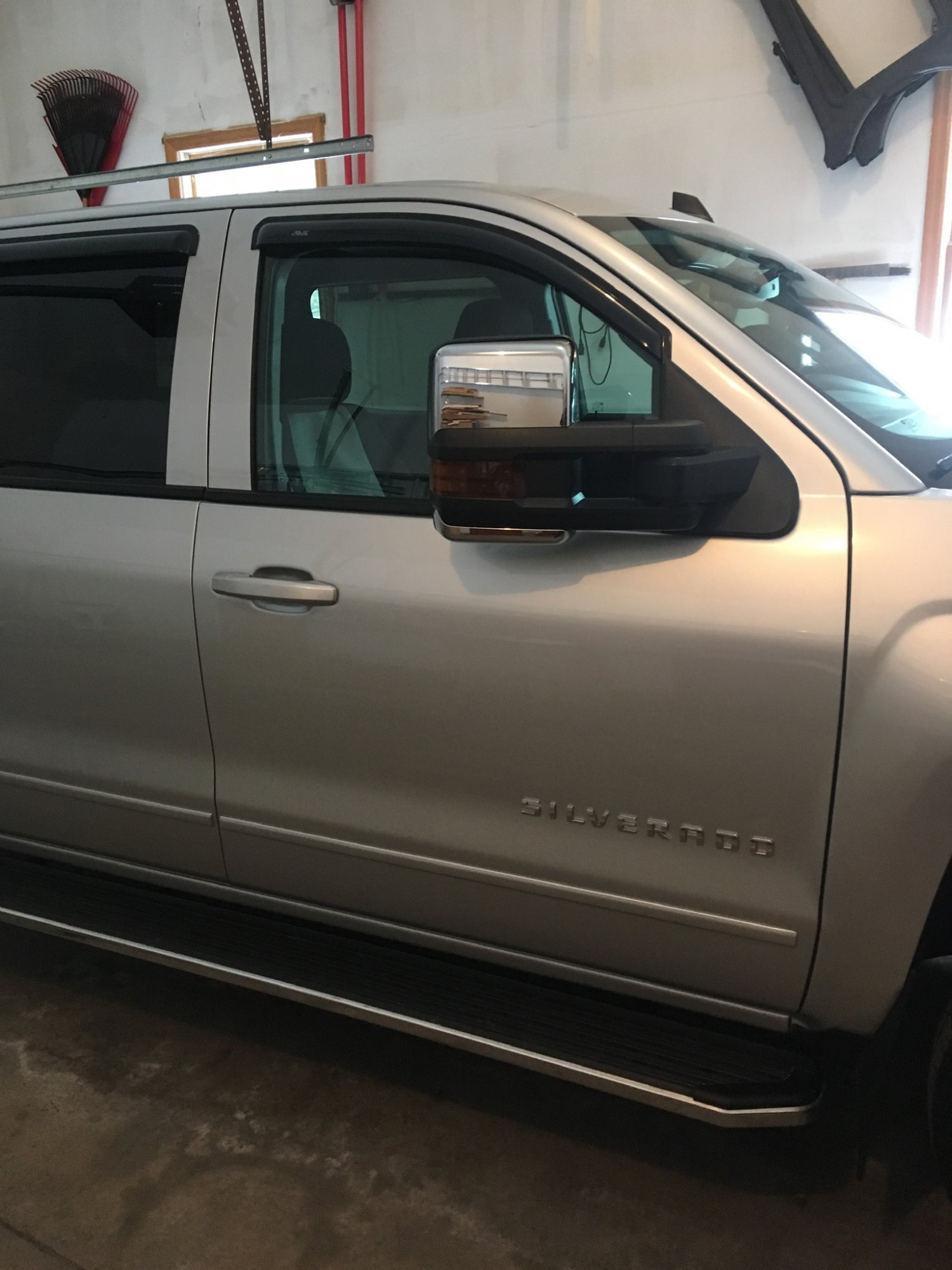

Phill I have a 2018 Silverado 1500 ltz red line addition with dl3 Mirrors and purchased a set of power folding tow mirrors with the back up light what harness shall I need to make everything work as it sholdshould
PM me. I have this exact harness configuration ready to ship.
I have a 2018 LT with DL8 mirrors. I have installed the DL3 mirrors with the power fold switch. I purchased harnesses 84290964 and 84290984. Will these work or do I need your custom harness? I also have installed the auto dim rearview mirror.
Sent from my SM-G935T using Tapatalk
Will not work. DL8 - DL3 will require a custom harness. Also, what switch part # did you get?
Since I already have the harnesses would your DIY kit work with these?
The DL3 harness will be of no good. The DIY Kit would be used in the your factory DL8 harnesses.
