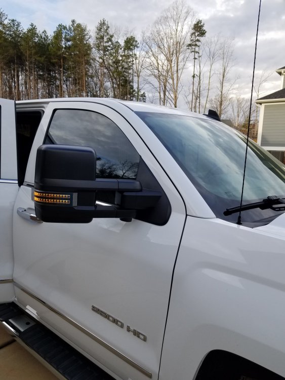

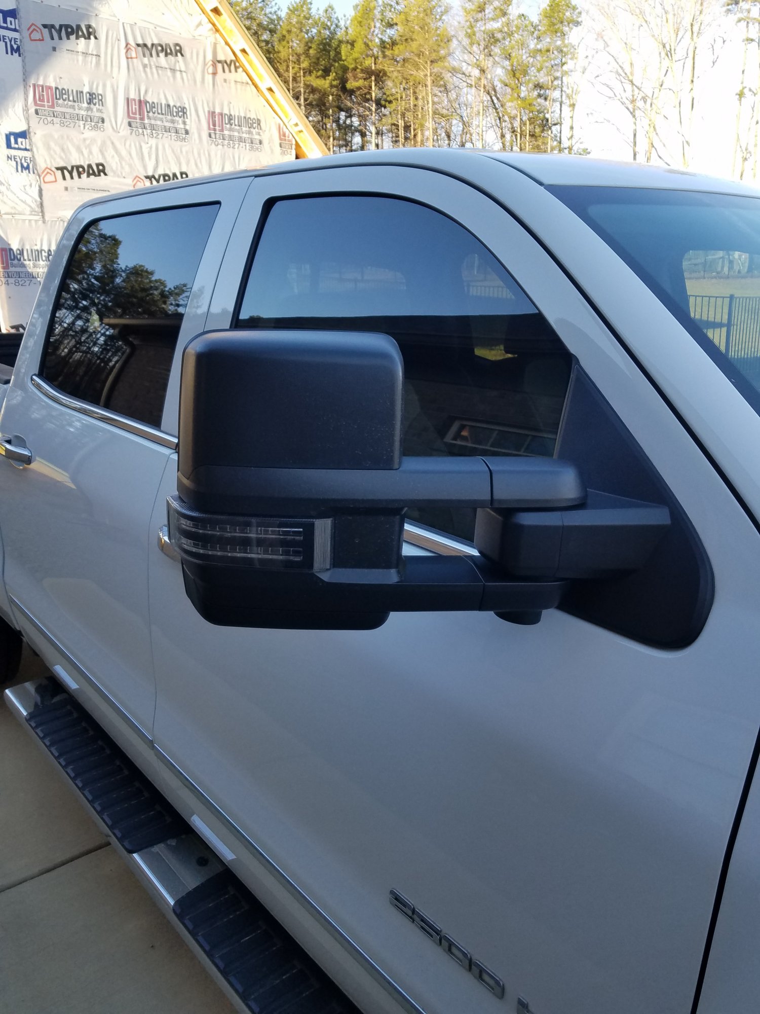

I am about to try a tow mirror upgrade on a 2016 Chevy 2500hd duramax with I believe DL8 mirrors. ( heated and power glass only) I found mirrors on eBay that are GM replacement with the turn signal, marker light, back up light, power and heated glass. all the bells and whistles. lol. I know from reading your page here I need a harnesses upgrade. what do I need, where do I get it, do you sell and how much? I want to do this right. boost auto has mirrors and a harnesses mod all for around $640 total. they say their mirrors are USA made and that they wire them for you all you need to do is modify your harnesses you have already. i guess what I'm asking is which way is better, yours or theirs? Thanks in advance for any advice. you  have already helped a lot. Steve

Steve, this all depends on your DIY abilities :). In my video, I show how to remove the door panels, remove the harnesses, and swap the mirrors.
Cost difference...
PnP Harnesses - $285 for the set shipped anywhere in the US. $100 is refunded if you send me your factory harnesses. Making the net total for the harnesses $185.
DIY Kit - $65. With the DIY Kit, you are modifying your door harnesses then reinstalling.
So total price different between PnP harnesses vs DIY Kit is $120. With my kit, I include the diodes to make to your cargo lights on the mirrors come in when in reverse. I believe this is a $20 upcharge for theirs.
Hope this helps. As for the Mirrors themselves, watch out for the $200 Ebay/amazon one. The market is flooded with them and many of them are not wired to factory specs. Some will tie the turn signal and running light together, some have the adjust glass wiring on the passenger side backwards so up/down controls will love the mirror left/right and vice versa.

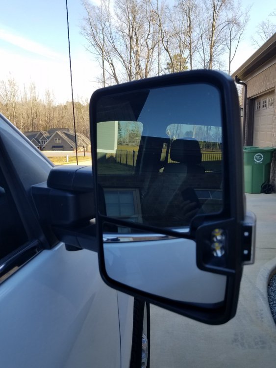

Finished installing my DL3 TO AMAUTO DQS mirrors on my 2016 LTZ. Couldn't have done it without Phil. He answered every question ASAP and his harnesses are top notch. He saved me a lot of money with his mirror recommendation. These look better than OEM mirrors, I think.
Thanks, Phil.
