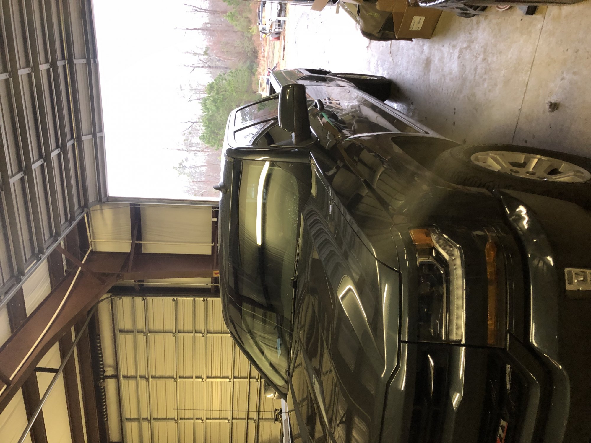

Hey, Sorry I didn’t give you better information first hand. I bought a set of aftermarket “DEDC” mirrors on amazon, they were supposed to have power mirror adjust, turn signal in glass, heated glass, running light, and the little reverse/clearance lights on the back side of them. As far as I know, they weren’t equipped with power fold/extend or puddle lights. Possibly part of my issue?
Anyways, I did not touch my factory DL3 door harnesses, I thought the towing mirrors that I ordered would be a plug and play upgrade. So I went ahead and made the extra hole in my door for the fourth stud (*doh*), and installed the mirrors. they plugged right in and I went ahead and hooked everything back up, put the door panels back on, go to test my install and the only thing I notice that works is the power adjust on the glass. No lights.
Anytime I used the turn signal (left or right), both front turn signals flashed. Not in sequence or anything, the front of the truck looked like I had my four way flashers on. The rear turn signals still functioned properly though.

The detailed information certainly helps. Based on the symptoms, this is a classic case mirror where they did indeed tied the running light and turn signals together. This is why the front lights exhibited the behavior. By tying these two circuits together, what is happening is that voltage was being backfed and introduced into the running light/park light circuit and Vice versa. Park lights come on, turn signals in the glass would come. Or some similar symptom.
The cargo light wouldn’t have worked since you didn’t swap out the door harnesses. The running light on the mirror was tied to your old puddle lamp (white downward shining light on your DL3 Mirror). So that amber light on your tow mirror would have come on at night, only when unlocking your truck.
