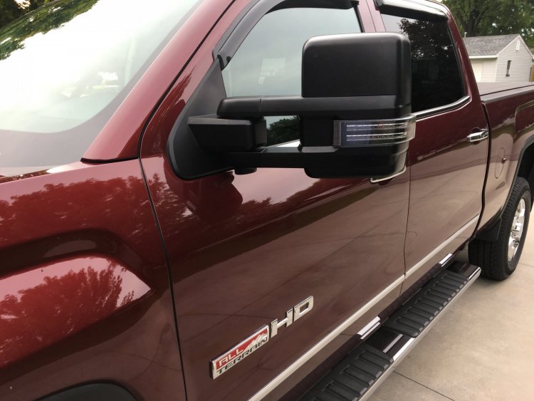

I upgraded my 2016 GMC DL3 mirrors to the 1A Auto Towing Mirrors, and used pgamboa's modified wiring harnesses the get full functionality.  The harnesses worked perfectly! Thanks Phil for providing a great product.
Attached are a few pics of the installation.
