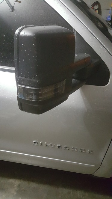

PGamboa strikes again! Couldn't be happier with the harness he created for me. I went from DL8 mirrors to tow mirrors very easy thanks to the help from Phil. This guy knows his stuff, he's super helpful, great communication, and gets you what you need FAST! Thanks again Phil!
Thanks for the feedback! Looking forward to new pics of your 1A Auto mirrors.
I may be new to the site but add me to the growing list of PGamboa supporters!
Luckily we live in the same city.
I drove my truck up to his place yesterday (Saturday) and we got my DL8 to DL3 conversion done in about an hour.
Well, actually, he did most of the work and I tried my best not to be a pain in his ass.
LOL!!!!
My main reason for the conversion was to have the power folding capability so I can more easily pull into my garage. (damn center pillar!)
The working turn signals and puddle lamps were just icing on the cake!
As we were doing the install of the new harnesses, he was pointing out some of the little "tricks and tips" he`s learned from doing these conversions.
So, whatever advice he gives, listen to it!
Once again, solid dude, buy with confidence and 2 thumbs up from this member!

LOL.. You were not a PITA at all! It was a pleasure actually. Just didn't want to get caught off guard with the storm. You are the first WT conversion and was really excited to see it all work!
