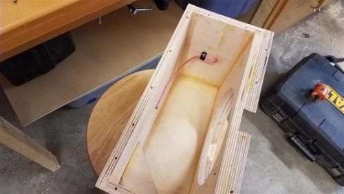

Here's a pic of the cabinet before it was mounted underneath the truck. You can see it has been shaped to fit around the fuel lines on the frame rail side.

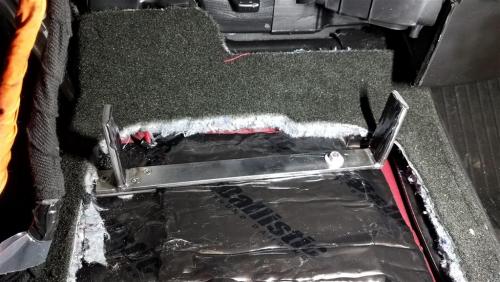

The best thing I ever did for my sound system was install full sound deadening my vehicle, from roof to floor pan. full CLD & LLP doors to floor, during my install I also covered the factory Bose sub with CLD...
and sitting in the rear seats, the Bose sub is really pronounced.

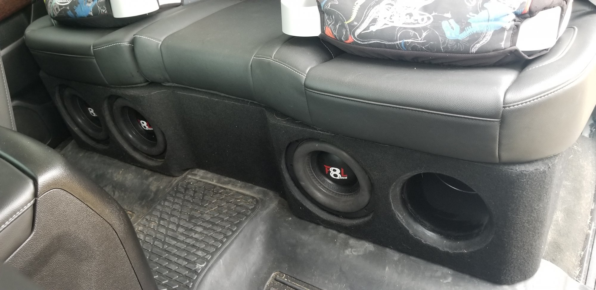

I did 3 high power 8s on 2400 rms. They freaking slam for what they are.
Lifted back seat 2 inches, box is 1.94 cubes net at 33 I think with a 6" aero port
That is a solid box. I did the lift c bracket thing because the downfiring box I have was too to the ground for the excursion of the skars. I think a front firing box would be so much better !

a few days, R&R interior is time consuming, but its far more work to "correctly" install the CLD & Foam &  LLP... but worth it.
also I didn't really show it but the doors are full CLD on the inside skin and inside frame.

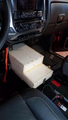

Ended up buying the center console box off ebay with the kicker comp 8". I haven't sold my 10" single box that goes under the rear seat yet, but ebay had a 15% off coupon so I decided to buy it. Here's a few pics of the install. I haven't wired it to my amp yet cause I have to remove my backseat to get to it. It was a little hot outside today with a heat index of 108 so I'll finish tomorrow. It took me about an hour and a half to install cause I was taking a few water breaks.
Here's a few pics of the console removed, the stock Bose sub, the new box with 8" sub next to the stock Bose, the 10" sub I removed compared to the others, and the new 8" installed before I put the console back in.42f7e3b4ad8232a97da7487c130bbc63.jpg4e492859dc2316718c9b7a9f9ccd8898.jpg5364e65ad4729206f569de094d742408.jpg3e2cbcd96c831a1522b3241cd33f116e.jpg
