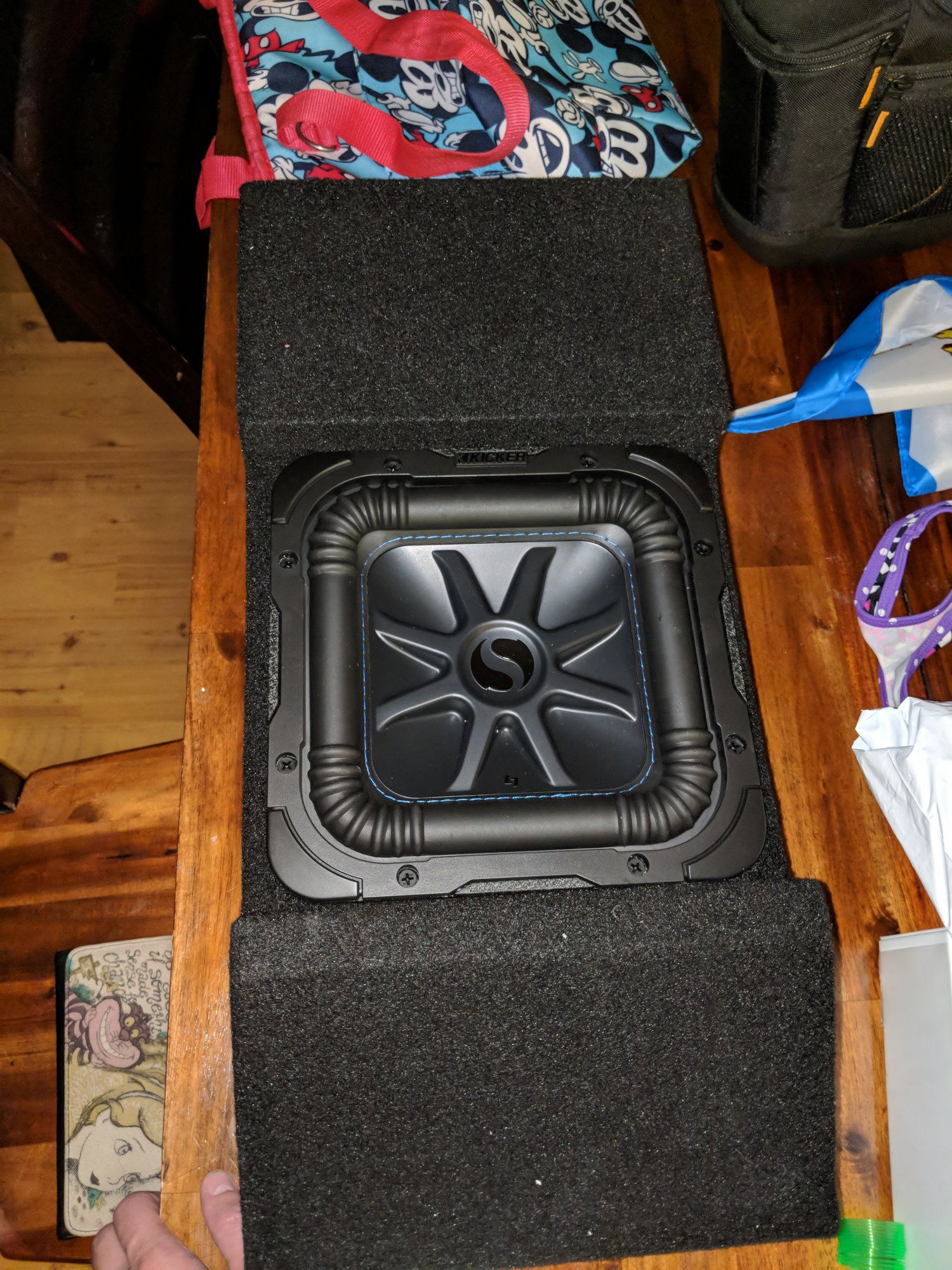

Ended up buying the center console box off ebay with the kicker comp 8". I haven't sold my 10" single box that goes under the rear seat yet, but ebay had a 15% off coupon so I decided to buy it. Here's a few pics of the install. I haven't wired it to my amp yet cause I have to remove my backseat to get to it. It was a little hot outside today with a heat index of 108 so I'll finish tomorrow. It took me about an hour and a half to install cause I was taking a few water breaks.
Here's a few pics of the console removed, the stock Bose sub, the new box with 8" sub next to the stock Bose, the 10" sub I removed compared to the others, and the new 8" installed before I put the console back in.42f7e3b4ad8232a97da7487c130bbc63.jpg4e492859dc2316718c9b7a9f9ccd8898.jpg5364e65ad4729206f569de094d742408.jpg3e2cbcd96c831a1522b3241cd33f116e.jpg

Nice. That is helpful to see. Thanks. Does the wiring look like it will be largely a direct replacement (once you get your amp in there)?
On the back wall are you going to run new power or share with the existing amp?
I'm just reusing my existing amp. I'm removing my 10" under the rear seat so I can put my rear storage back in. All I have to do is connect the speaker wire from the sub to the amp, but I have to remove the rear seats to get to it. While they're out I'll also be able to adjust the amp for the new sub.
