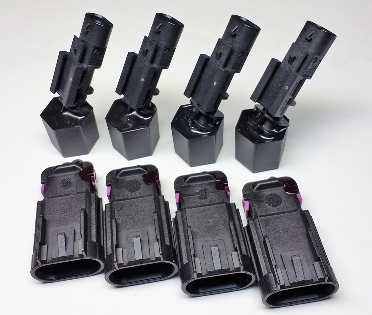

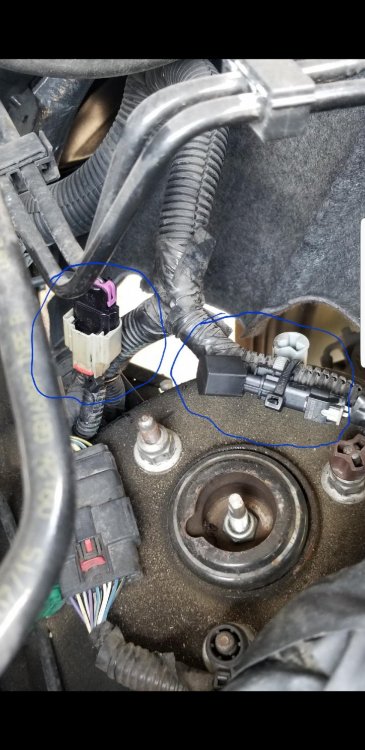

I had Lowered my 2015 Sierra Denali with Magnetic Ride Control causing "Service Suspension Soon" message to show up plus it wouldn't let my truck go over 80mph.
I purchased Shock Simulator Kit from http://.xineering.com/shocksims.html  which bypassed the "Service Suspension Soon" message and
truck was back to normal...
