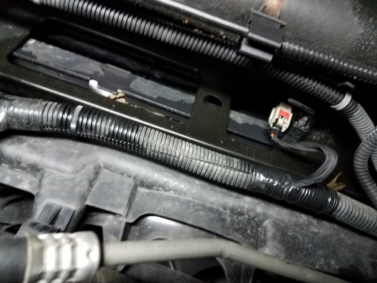

Just found this thread and I just found the hose leaking on my 2014. I am at 97k miles. For those that have replaced the line, I can see the block just above the oil filter, where is the cooler end located? I believe mine is also leaking at that end because there is oil at the radiator/condenser support also on mine.

I am 2wd so it may not be as bad if I do have to replace the lines. I just had the radiator replaced under warranty about 1000 miles ago. I believe the majority of my leak is from one of the fittings at the radiator and the fix should be on them. Most of the leak I see is under the radiator and condenser. The leak from the oil line is minimal at this point.
