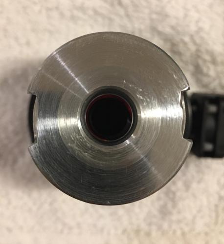

I just received my kit today and wanted to install the kit this weekend but looks like I might have to get the newer filler neck fitting? This measures at 1 5/16" (1.3125"). I have a 2016 Sierra.
Take a full picture of the bottom without the tape in the way so we can see the receiver channels on each side should be different in size on the larger 1.390" unit and the smaller 1.320" unit has the same size receiver channels on each side. If this is the case I will send out the correct part with a call tag for the part you received. BTW, what size shirt do you wear and I will throw one in for you. We have some really cool new American Flag Team UPR shirts we just came out with.

Does this work? And large shirt :)
That works perfect and it the smaller unit, so the correct unit will ship out today with your large Team UPR Shirt.
