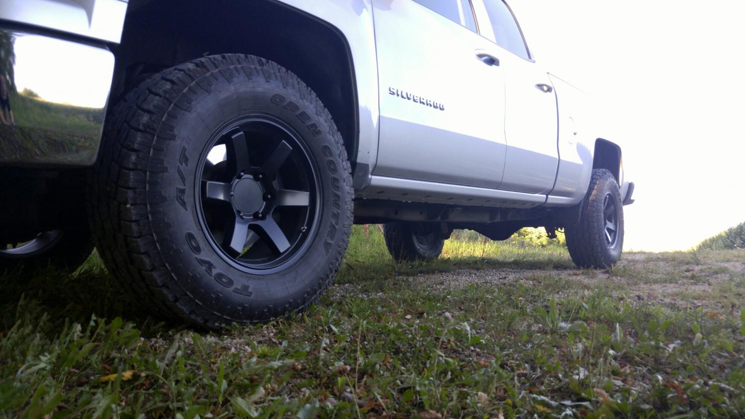

Those look great. I have those same rims and I will be getting the duratracs. Does anybody know why some people's trucks rub using this size and some don't? I'd rather not spend the money and time install a level yet if I can get away with leaving it stock and not rubbing with those tires. They don't rub at full lock or anything?
Here are some more pics of mine at full lock. They do not come anywhere close to the front sway bar or any other suspension parts or frame (first 2 pics). And at the back rear side of the tire they do come close to the carpet wheel well liner but does not ever rub (3rd pic). I can slide my fingers between the gap. On the front side of the wheel well there is even more room (4th pic). I see no signs of rubbing or scuffs anywhere and with the closet spots just being the wheel well carpet material I dont see any big risk. And I've had these on for almost 37k miles.
I had this exact same tire on my 2005 Silverado and it did rub slightly on the suspension at full lock but not on my 2014.
Thank you! That really helps. Makes me feel a little bit better about making the purchase. It definitely looks alot better without those little 255's.
