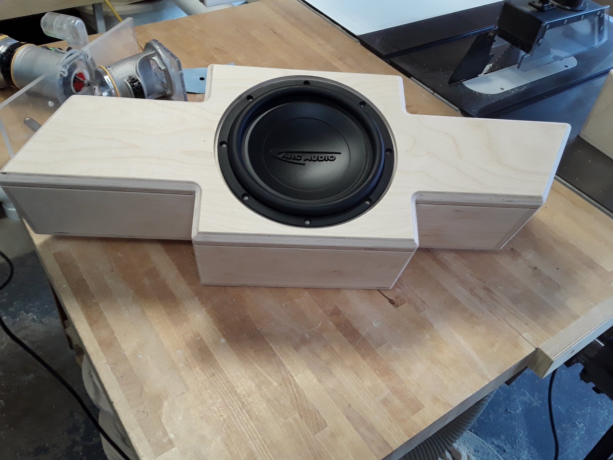

Got bored the other night during this shelter in place and built yet another subwoofer enclosure from a combination of 13mm and 18mm Baltic Birch plywood to scale from an actual Bowtie emblem. 709205017_2020-03-2917_42_08.thumb.jpg.7c5409a6ce45fc440d82ac531b6e27f1.jpg
