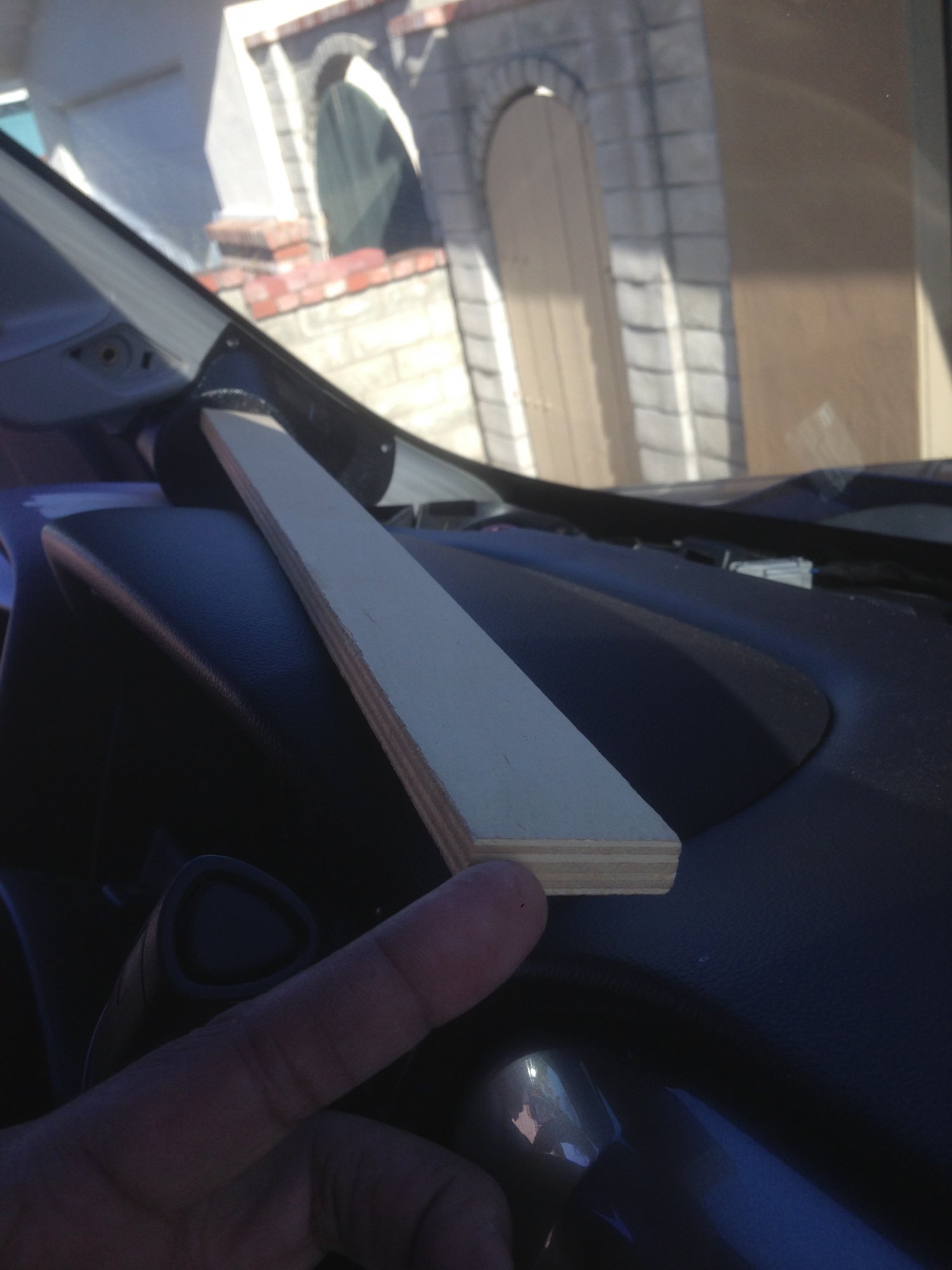

Pods fit the pillars perfectly however I cannot get the pillars back in due to the lower portion hitting the dash so I'm gonna have to trim where the tape is as well as the bottom edge for them to work (I'm just using smaller chambered tweeters so it should be fine however I'm not sure how well these will work with mini mids)
After trimming the pods I was able get the pillar back in however another issue arose. The pod is stated to be aimed 6" in front of the headunit at center and slightly upward which I found from my previous experimenting would work fine however they are actually aimed right at the top center of headunit and slightly downward which is definitely not going to work. My guess is something goofed in production (these are made on a 3D printer) and I brought it to the attention of the maker several days ago however the only reply was they may have been a pre production design so I'll withhold judgement on these until or if the issue is resolved.

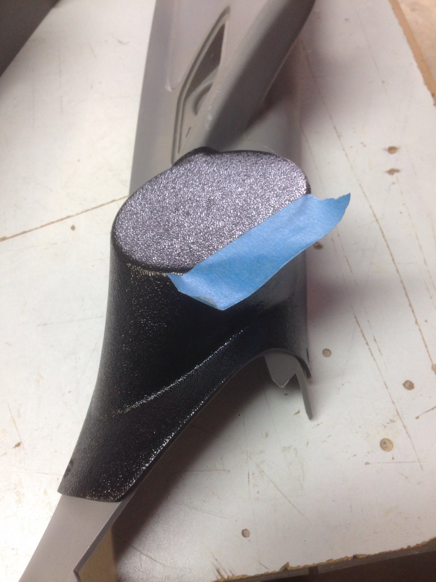

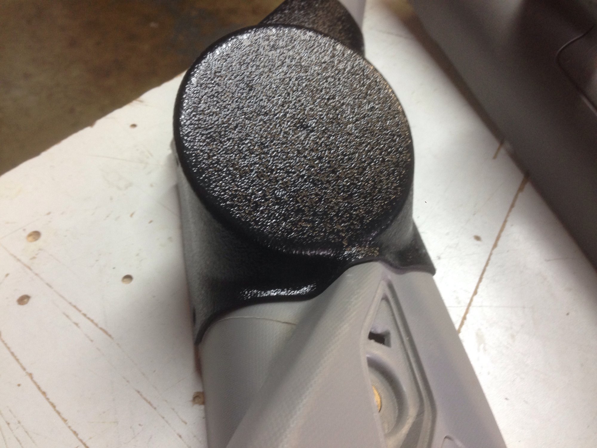

Sprayed my a-pillars black using SEM Bumper Coater as recommended by the automotive paint shop owner since it did not need adhesion promoter and is more durable.
  • 3 weeks later...
Forgot to post this is what I used on the a pillars per the recommendation of the paint shop owner. As simple as scuff, wash off/dry and spray several light coats. Also, if you get fiber snags from a cheap micro fiber cloth as I did you can knock them off easily with the scuff pad and spray another light coat.

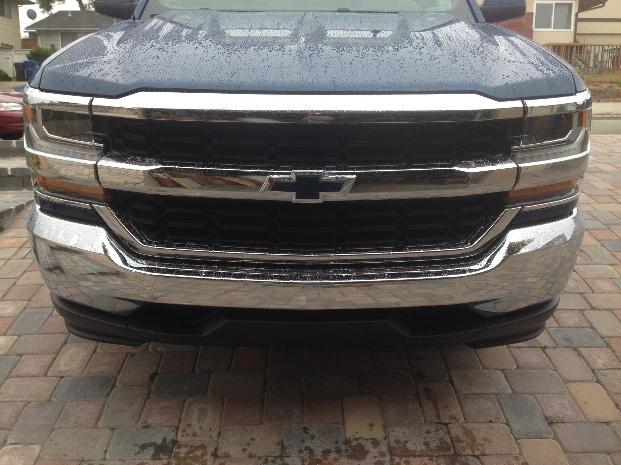

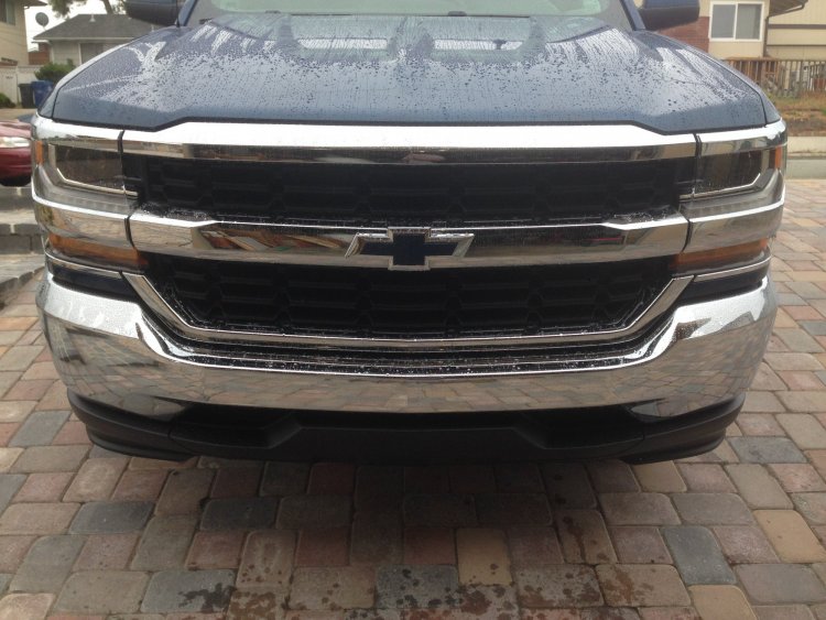

A little Fathers Day gift from my daughter who knows I'm an old school chrome kinda guy but wasn't willing to pay the ridiculous 600 bucks for a plastic chrome LTZ grill. I prefer to make my mods look like they could have been done at the factory and I think this fits since it is an exact duplicate of the factory grill  in a chrome overlay as opposed to a "custom" look like the mesh ones etc. I think it will look better once I have the new front bumper color matched (I found a ready to paint steel bumper for not much more than those paintable covers they make) and I'll most likely leave the rear bumper chrome to kinda mimic the'73 Corvette  look.
