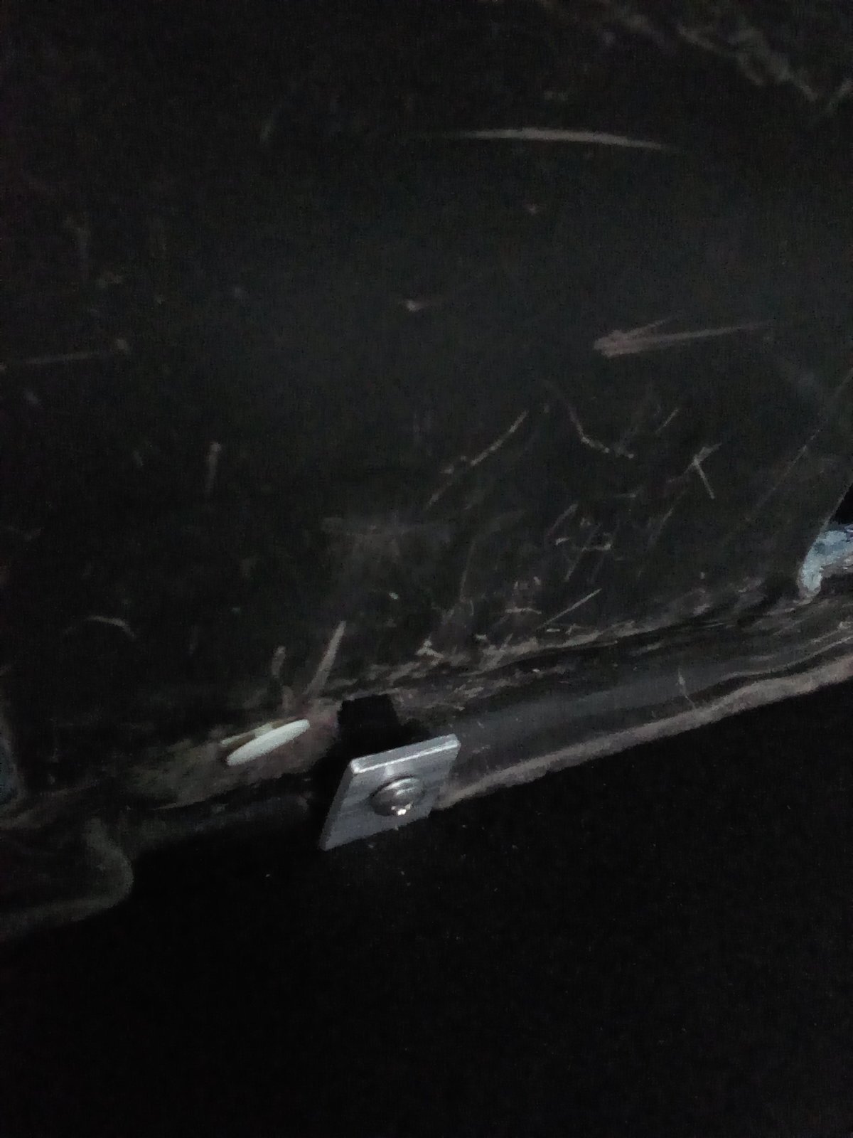

Temporarily installed the enclosure with some rubber insulators but I'll need to get some longer bolts so I can isolate it on both sides of the bracket.IMG_20190203_172151.thumb.jpg.34e15c4f12afeb7cf0a2a20445e4aa53.jpg

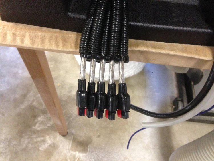

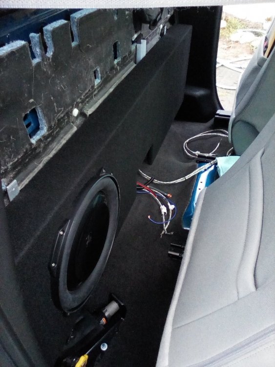

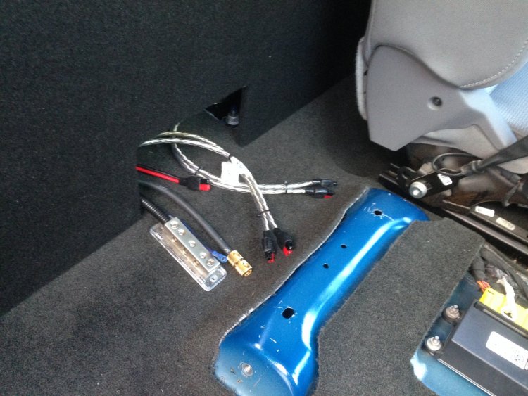

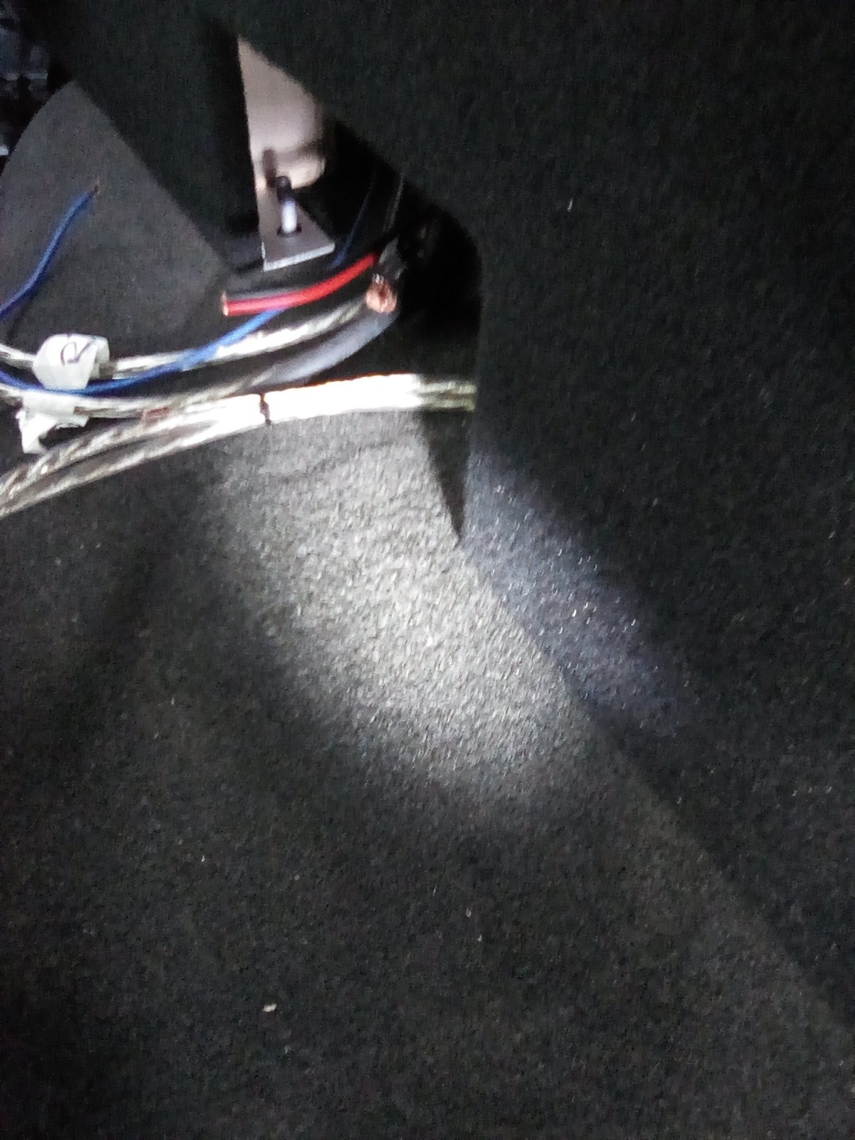

Found it was going to be a pain trying to get the wires under the carpet so I re routed them through the back of the jump seat and added the Anderson Power pole quick connectors.
Edited by Marv88

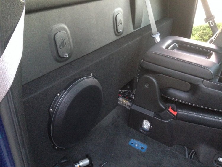

Installed and all wired up. I still have to figure out something nice to cover everything up.
Edited by Marv88
